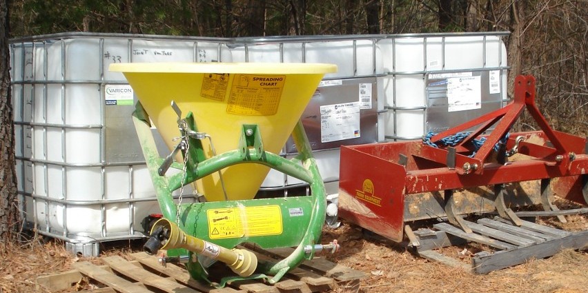

Guys,
I want to build a simular 3pt sprayer but haven't got a tank or sprayer yet.
I've priced available sprayers and they are OVER $500 :mad:
What I DO have is a 100 gallon tank, one of those encased in a tubular steel cage things. I'm thinking that I could mount it on a rear arm platform or tow it on a small trailer. (only put 75 gal or so for weight) see photos...
Build a boom out of 1/2" PVC. then presurrize it with a 12V air compressor.....
....I KNOW one of you guys has built something like this.....please advise....I HATE to spend $500 for something I'd use 3 times a year.

Is the 12V air compressor going to be better than a 12V pump? If you get a little Shurflo diaphragm pump you have your system built. The trick is sizing your pump and your nozzles to match.
   / Look at what I "built" today #19

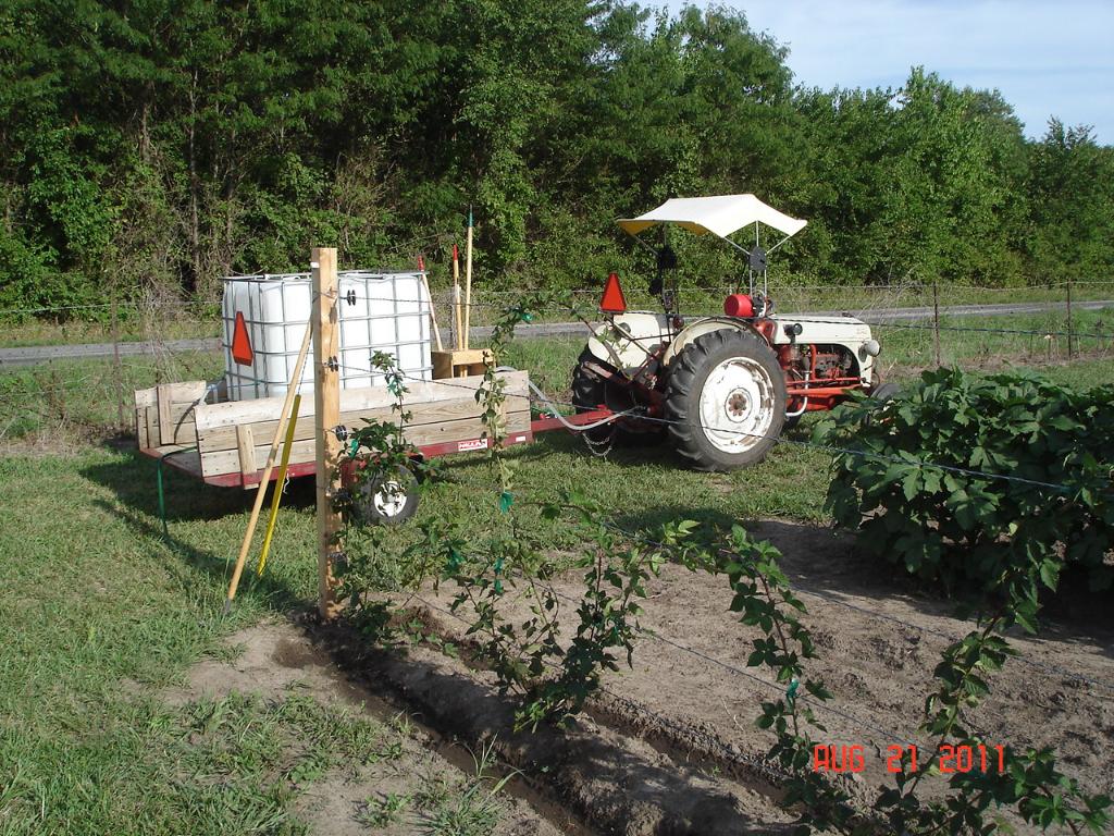

-Boeing- what you've done is pretty much what I'll be doing with my 275gal totes. I'll be using a couple of lengths of PVC pipe or possible copper to make my booms. Set up in a way to allow at least 12ft of spraying for my pastures.
Good luck.
   / Look at what I "built" today #20
I appreciate the ideas...
I had a 12V pump on a boat years ago and it worked great for the sink and shower.
HOW....do I "size" nozzles? Think we can "screw" nozzles into PVC? I see that most spray booms are 140" which would give about 6' per side....and they use 3/4" piping with some kind of supporting bar across the top.. What I DO NOT know about is the number and size of nozzles that a 140" boom sprayer can support. It makes sense that the more or larger the nozzles the more pressure would be needed. I see 12V pumps that move 200GPH and 260GPH.....HOW do I take that knowledge and apply it to nozzle volume. The spray boom should be simple but we want it to spray and not dribble. Who knows this type of info???? We need a sprayer engineer..... :confused2:
