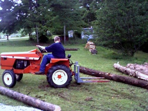

I took an old set of forks and some heavy channel and made me a set of 3pt. hitch forks for my baby tractor. A/C 616. It works good for moving pallets and have moved a few logs and poles around with it. Wouldn't want to tackle a round bale but hey, its something to play with

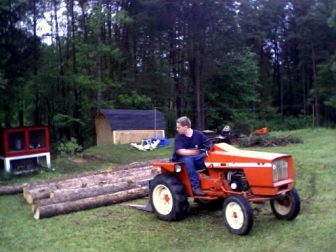

next pic.
