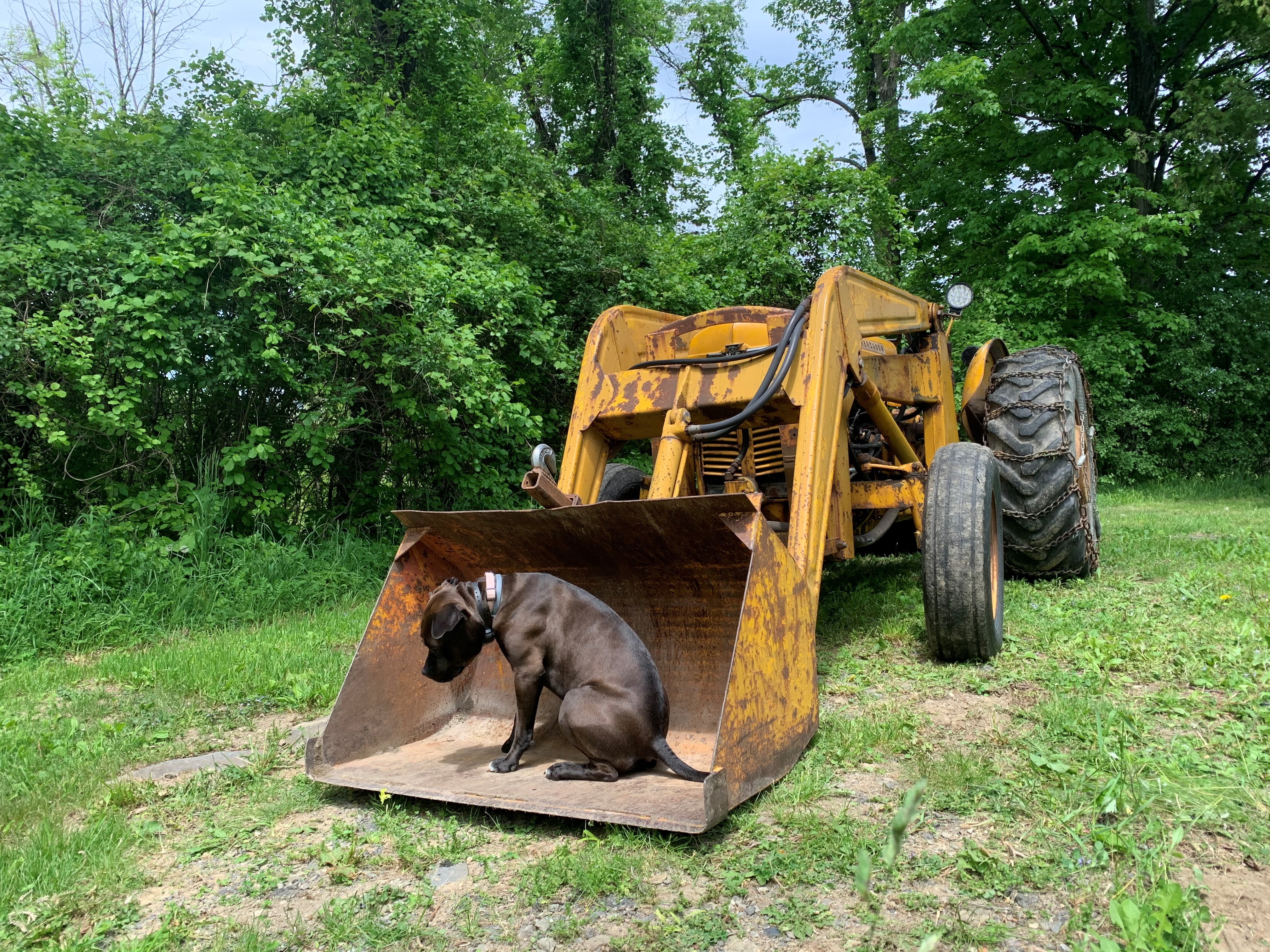

Pete, this is a touch off topic from grapples, but do you think you could post some pics of your linkage upgrade to increase roll-back/dump angles?
I don't have any photos that would show what I'm doing particularly well, but my loader is an old style with a single central tilt cylinder and I am modifying it to the more modern style of two tilt cylinders, as well as the double-pivoting system that attaches the rams to the bucket- like in this TBN photo https://www.tractorbynet.com/forums...64-what-fel-my-tractor-tmp-cam-1184676645-jpg
The second linkage enables the upper pin of the bucket to go 'over the horizon' from the cylinders. I don't think I've explained that well! I'll either post a separate thread on the loader rebuild when it nears completion, or add it to the tractor rebuild thread.

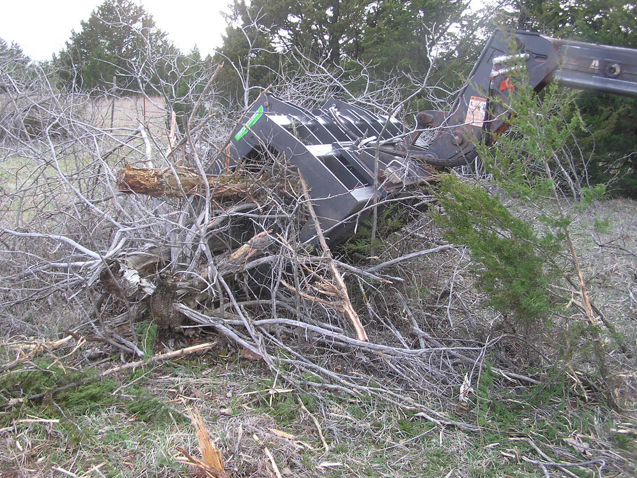

I am surprised you would choose a clamshell style root grapple for that job. My first grapple was a clamshell style with two lids. did not pick up bulky piles well, a lot would fall out the bottom: https://www.tractorbynet.com/forums...ying-new-grapple-post4622699.html#post4622699
I now have a two lid 72" flat bottom and six tine 44" that move brush, limbs, trees and rocks very well.
And that is really great info, thank you. As the darn things are virtually unknown here, I can't exactly get a heap of experience with different types! A lot of the use for a grapple on my property will be picking up piles of cut branches so it sounds like a style with the long bottom tines would suit the job better. Thanks again.
Nice, I ask because I've been considering the same upgrade for my machine, which also has a single tilt cylinder. I look forward to your future pictures, should you decide to post them! :) You can see mine here:

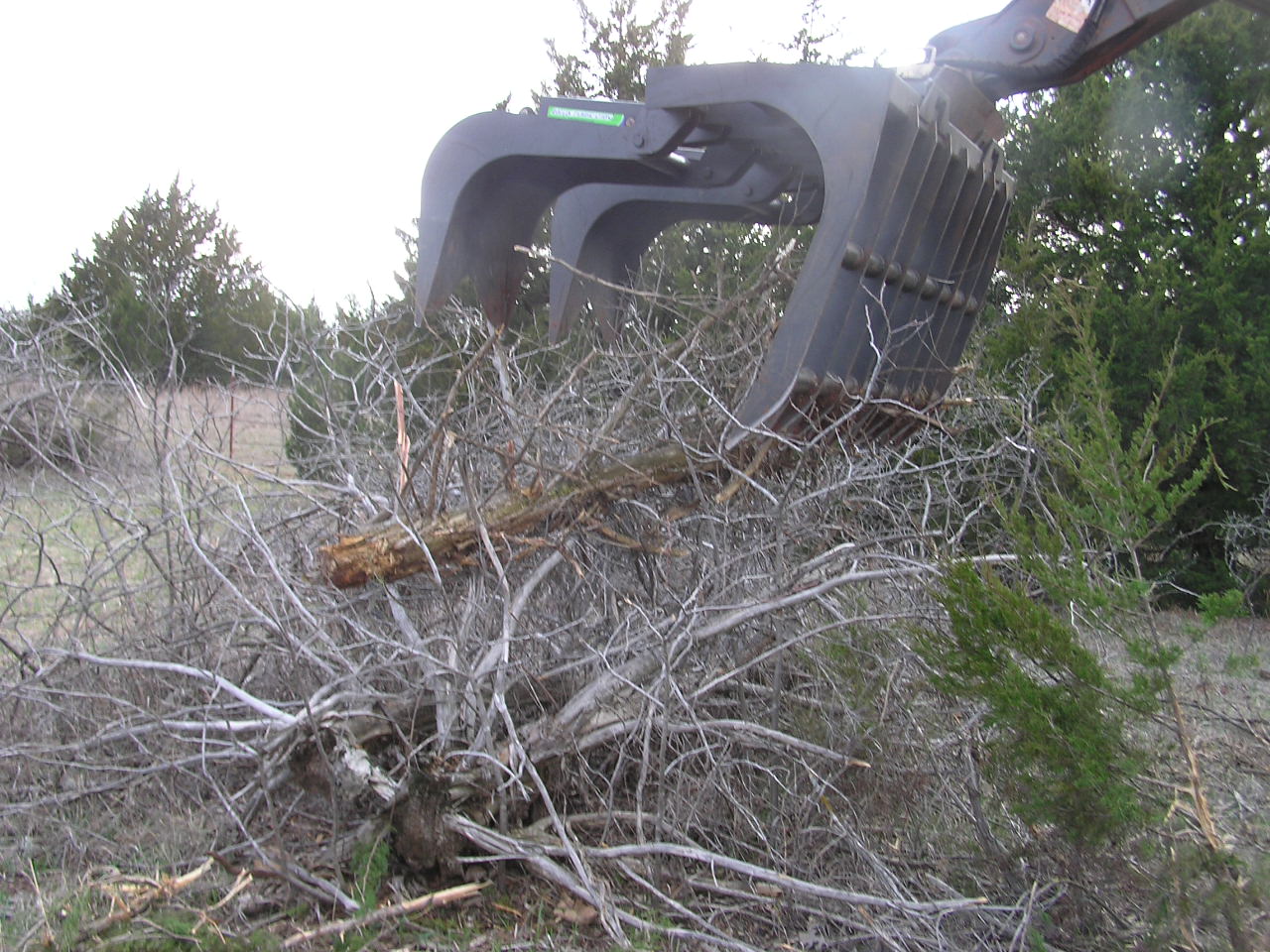

You're welcome. Any grapple is better than no grapple and the clamshell style works good on small tractors. The long flat bottom style has room to hold more branches with the lids closed:
