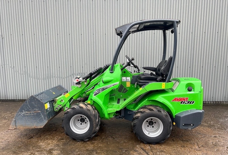

Looks like you're mainly doing loader work. Are you sure you're not better going with either a skidsteer or one of those front loaders like Avant, Giant and more? Machines designed entirely for loader work.
