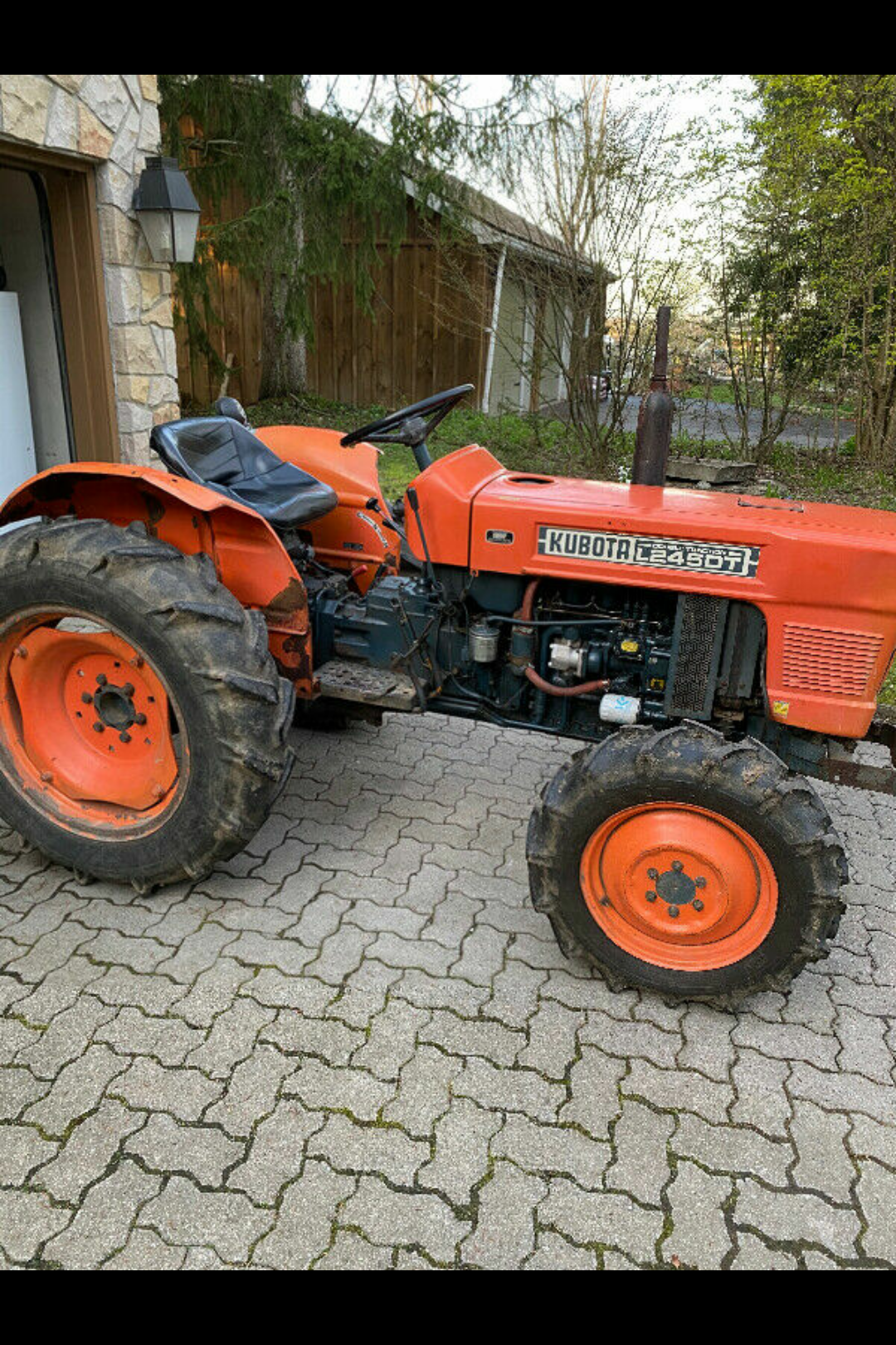

There is a Kubota L245DT which would be a little bigger with a wider wheel base. I would have to replace the tires with more turf friendly tires, not sure how much that would cost.

Kubota L245

A much more capable tractor.

'Independent' is the most desirable type of PTO.
Unless you have water-retentive clay soil the R1/ag tires shown in the photo should be fine on lawns with only 2-WD engaged.
The tractor is only 2,380 pounds.
Likely the tire tread is fairly worn.
If you will pull boats up wet boat ramps, wider, softer turf tires might improve traction. Sharp sand and/or cat litter will also help tires grip wet concrete. You will need new rims as well as tires.
