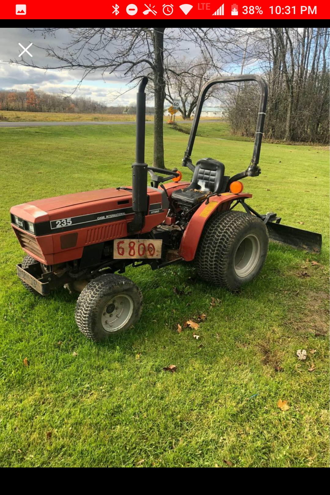

What about an IH 235? It's a lot closer than the Kubota. There is Kubota B8200 within range.

   / Looking at an Allis Chalmers 5015 #19
Here is a LINK to tractor data.com:
You have exhausted the time I have for you.
I suggest starting a fresh thread.
Leave out all reference to your Case 446.
Focus on your applications for a replacement tractor.
Add your LOCATION to your T-B-N PROFILE.
