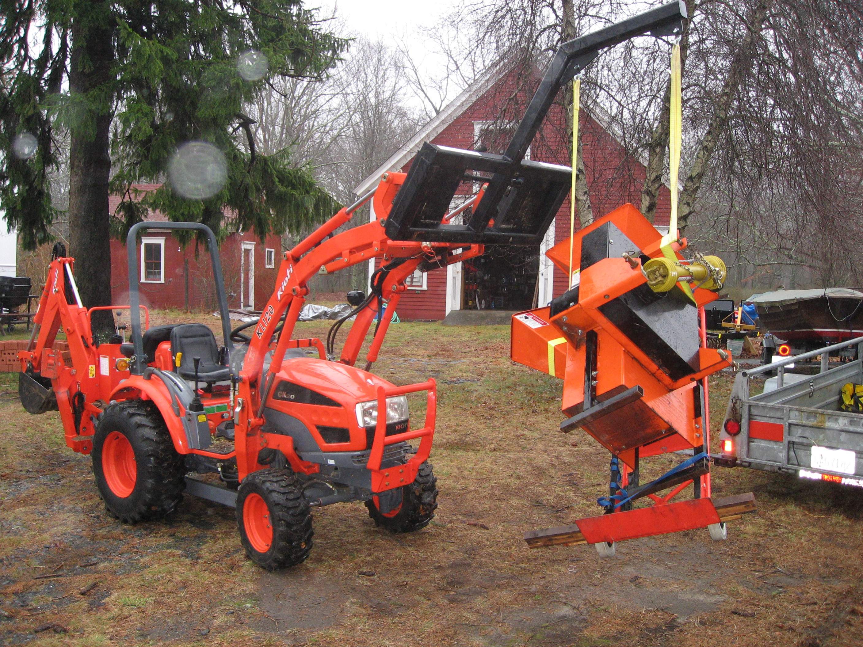

Just to chime in with a slightly different perspective.... The CK2510 is essentially the replacement for the CK20s. The CK2610 replaces the CK27/30 as best I can tell. The CK20 and CK27/30 each have had very loyal owners and all of those tractors were/are workhorses. I used a CK20 with 1070lbs of loader lift and a six foot backhoe to clear about three acres of overgrown land. I then replaced it with a DK40se and a 9 foot backhoe and cleared another 5-8 acres. Was there a difference? You bet there was. Doubling the horsepower and going up more than 150% in loader capacity made work go faster. However, other than lifting one specific 2000lb rock and a few large stumps, there was actually no task that the DK40 set up did that I couldn't have done with more time using the CK20. I think the same will be true of the CK2510 compared to the CK2610. I do like the bigger loader on the 2610 and agree that a three speed hydro is much more pleasant to use. However, I'd still say that for a three acre lot the CK2510 is more than enough tractor. And, if I had an extra $3300 to spend on a tractor, I'd seriously think about the work potential of a CK2510 with optional SSQA and a grapple ($1500) plus a boxblade ($750) plus rear remotes ($500) and compare that setup to a plain CK2610 for the same budget. If money was no object I'd take the 2610 because of the loader and 3 speed hydro but honestly for a three acre lot that would be bordering on overkill.
Here are a few things you can do with a loader that lifts "only" 1070lbs with an SSQA grapple operated off rear remotes:
Nice pictures!
I didn't mean to say that smaller machines are useless. Personally I'd love a B series Kubota with all the bells and whistles. I'm thinking cab and front snow blower would be pretty trick.
I just wanted to demonstrate to the OP that he is the one who needs to determine the value of these machines for himself.
