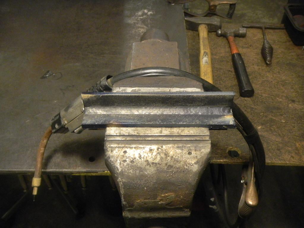

As I was telling you last night, my brother-n-law has my Everlast PowerArc 300. If you don't mind, I'd like to try one of my LN-25s on your PowerArc 300?
I was very impressed with my brother-n-law's PowerArc 200ST, with Lincoln's NR-212 self shielded wire.:cool:
