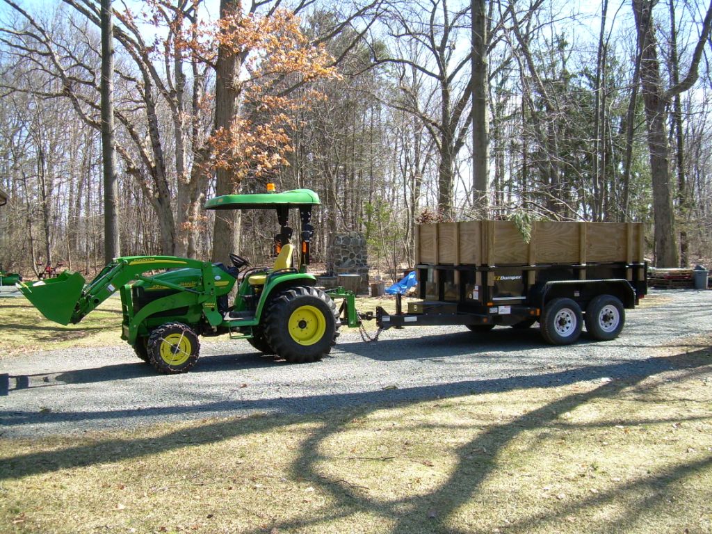

I didn't read all the posts here so don't know if this was suggested already but what about a dump trailer, moving buckets, one at a time is very slow.
When I had alot of dirt to move, I used a small home made trailer and dumped it with the loader, I've since got a 5 ton dump trailer which will work great for my next high volume dirt moving project.
The dirt pan looks like a great implimant but it's only a one use tool, and even though it may cut the amount of trips in half or better, that would still be slow and low productive IMO.
JB.
