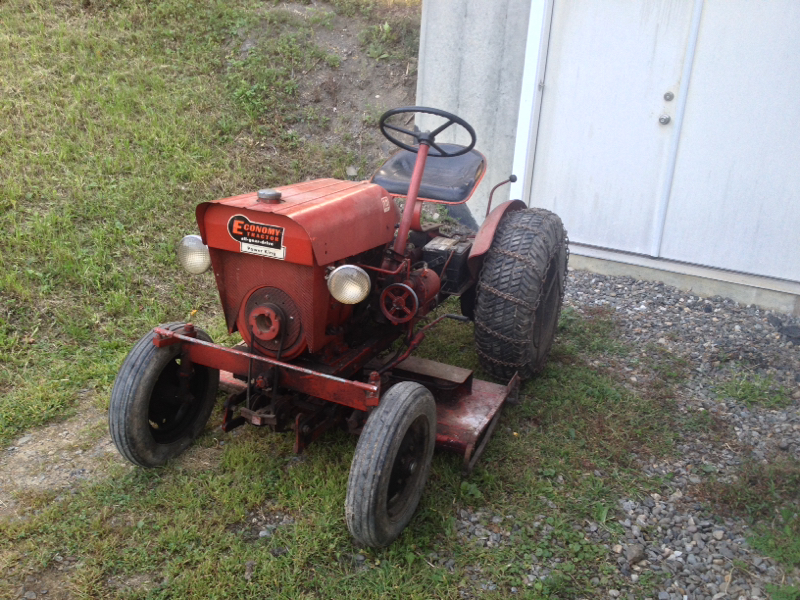

I picked up a 6' McKee Snolander 520 for my larger machine, and I just got this all tuned up and running great. 12hp horizontal Kohler, and I've got the 44ish inch wide blower for it, too. Can't wait to see what it does. Twin transmissions, this little guy is a beast!
