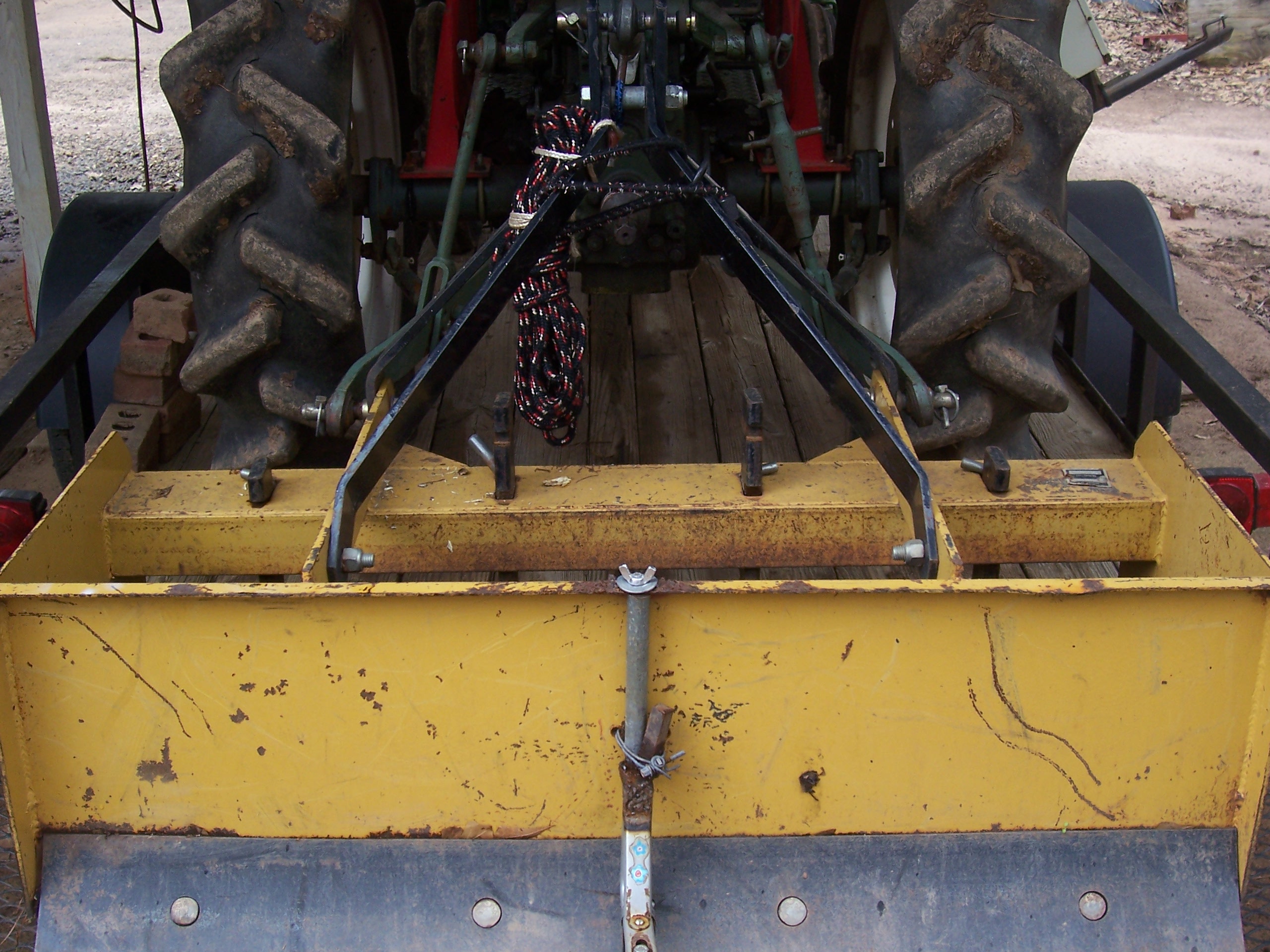

I have a 4ft box and it's perfect. It will pull with all the rippers down and can pull a pretty full box but I admit never pulled a box full of gravel or crusher run where it's spilling out the top, to say but I feel my ym2000 which is the same as the ym240 could pull it.
   / Looking at YM1700 this Weekend - What Issues Should ILlook For? #13
I've been using a 4Ft. BB for just over 10Yrs.. With my rear wheels reversed it's the same width as the 2000's rear end Displacement. Works great without having to look behind you not to catch it on anything. I have quite a few hundred feet of crush in run for my driveway and with Org. Rice lug Bridgestone's It takes a lot to get it stuck. Once it make a pass with the rippers lowered to loosen it up there's not much to it. I am so glad I used Gemplers Reliners to be able to keep them. Not the first complaint!!
