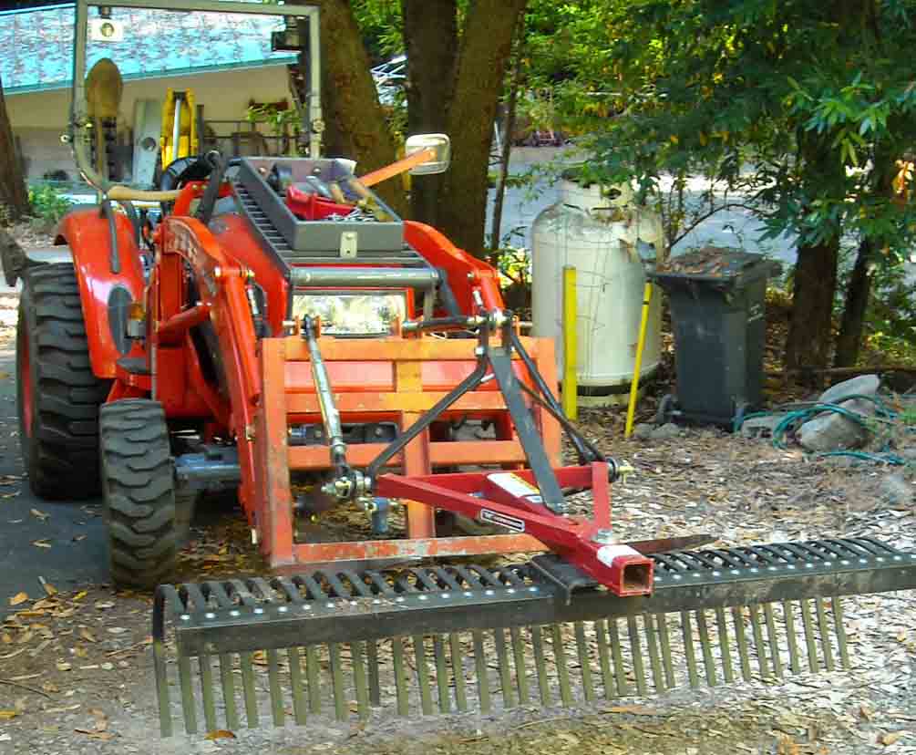

   / Looking for 3-point adapter for Loader #8
My approach was a little different since I wanted the same side tilt
capability you have with a rear 3PH. I welded up a 3PH with arms
and links that fits on my pallet fork frame.

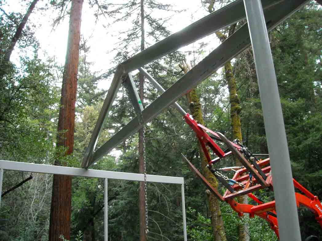

Here is my rake, which I can adjust for side tilt. I also fit a pole inside
the rake frame after removing the rake, and have a front-mounted
boom pole.
