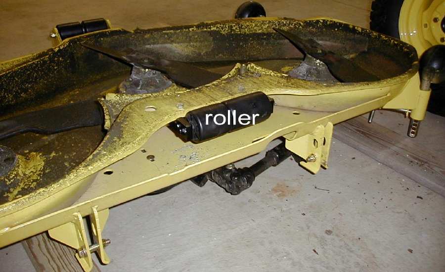

On all my 54" decks, I've added an anti-scalp roller at the rear/center of the decks. Deere used to have such anti-scalp rollers, but quit putting them under the decks. This is shown on my X485 54C deck but same as the ones I added to my other two 54" decks.

I really like the roller you have added....it is exactly what would help on our rough ground. Is it welded or bolted to the deck?
   / Looking for a 54" cutting deck for JD 425, 445, 455 tractor? #14

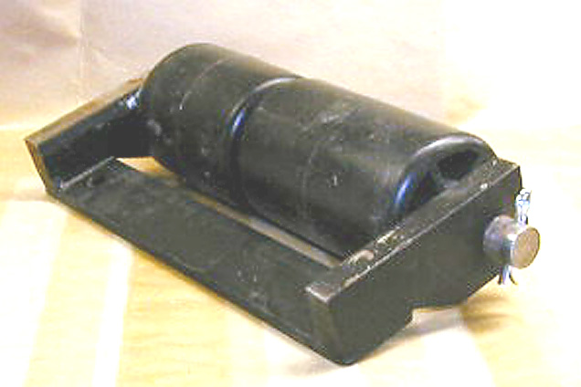

Bolted on. Some half inch steel, with a notch to go over the deck lip, welded to a 1/4" strap. Some 1/2" rod through a couple deere rollers... kind of copying the front center roller.

Thanks for posting that image.....I can build it from there.
