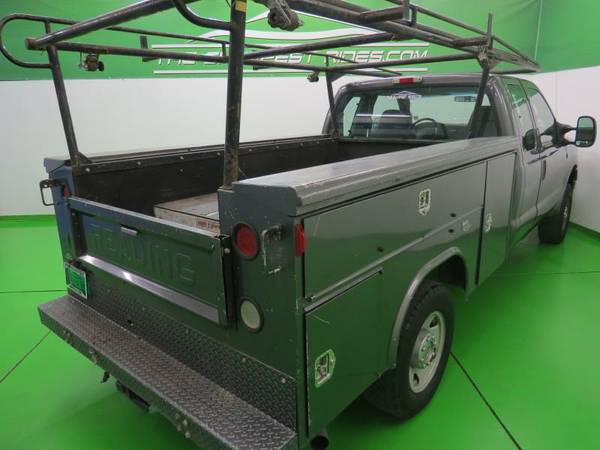

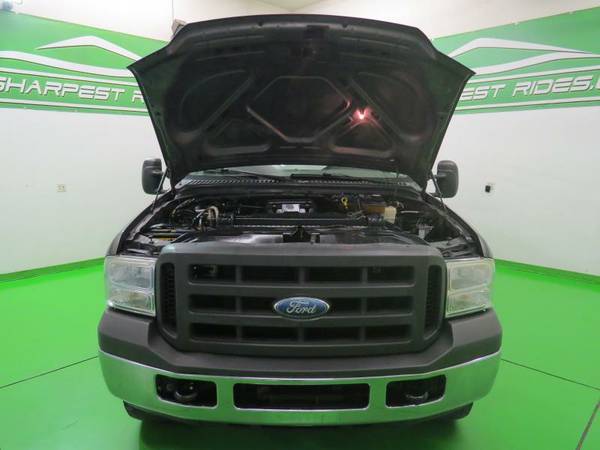

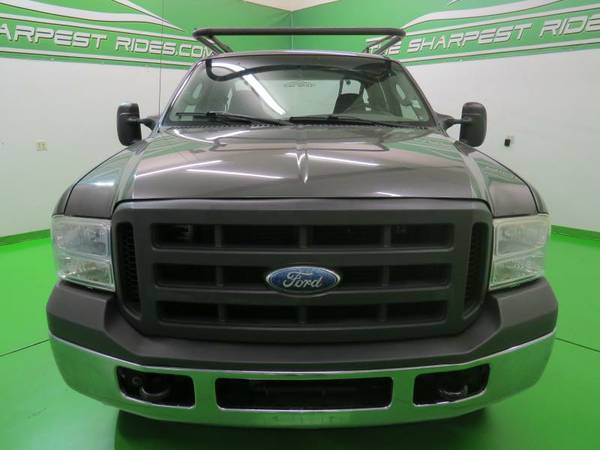

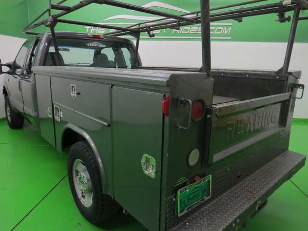

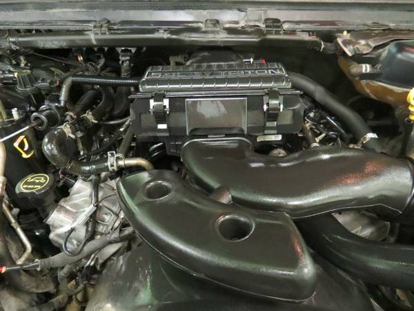

You don't always get what you want... Looks like I got a V8 gas rather than my preferred diesel.
2005 F250 XL 4x4 automatic with 220k miles & a service body for $4,250.

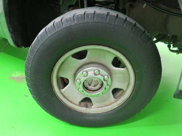

Something on the drive train is a bit rough, I'm assuming I need to replace a front wheel bearing. Windshield has more crack than Charlie Sheen, A/C is nice & hot, front tires are toast, rears are a little ways behind. Other than that things are in pretty good shape. Cab was extremely dirty, but cleaned up reasonably well. The engine is nice & smooth, steering is a little sloppy, but way better than every other F250/350 I've test driven.
Probably dumping at least a grand into a new windshield, tires, spare keys & changing out all the fluids here ASAP.
We'll see how well the service body works out for me. I may end up trying to sell/trade it on craigslist or something & get a flatbed for it. The rack has a high likelihood of coming off sooner than later.
Pics or it didn't happen... Well I'm lazy at times & am just reusing the dealers photos they posted...
looks like a good value. Those Ford gas V8s run for a long time

Truck looks a whole lot better then the description you gave. I was surprised of how good the condition appears to be. I would leave that rack on, you'd be surprised how handy it would come in. I wish I could stumble across a deal like that, you did very well. Not sure if you realize just how well.
   / Looking for a farm truck... #27
Looks good ... and the utility bed will come in handy unless you are wanting to go gooseneck. The sides are usually too tall on them to use em for that but they are great for having everything you might need handy on them.
