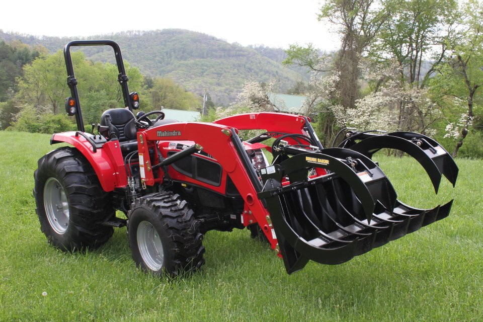

Wish I would have seen this thread earlier so I could've suggested the grapple I bought. Brush Raker by Oliver Dalhman. Mine is a beast. Absolutely love using with the Mahindra 5035. Did have to fill the rears with Rimguard though.
