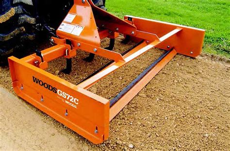

I bought a JD 4 foot box blade last year and it seems heavy duty.
   / Looking for a heavy duty 4' box blade #15
Apologize if this is in the wrong forum.
I have a mahindra 25hp emax hst that weighs around 1500 pounds....1700 with me on it. I've pretty much settled on getting a 4' box blade. It's going to help me maintain 1/2 mile of dirt/gravel road. Smoothing out pot holes probably being the main job.
Looking for recommendations for a heavy duty box blade that will last at least for a few years. I have a mahindra dealer nearby as well as tractor supply and a massy furgusion dealer close.
Who makes a cat 1 4' box blade that will last?
I have the county line 4 footer from TSC, very tough-well built. I have a 24 HP and will always lose traction before I lose the HP to pull it...I actually have yet to lose the HP to pull it.
Have done 18-18 yard truck loads of 2.1 gravel with it. My only complaint is once again-traction but I have turf tires.

I built a suitcase weight rack for the front of my JD2210. When using the BB I throw a couple weights on. If I begin spinning I pick up just a tad on the BB and no more spinning.
