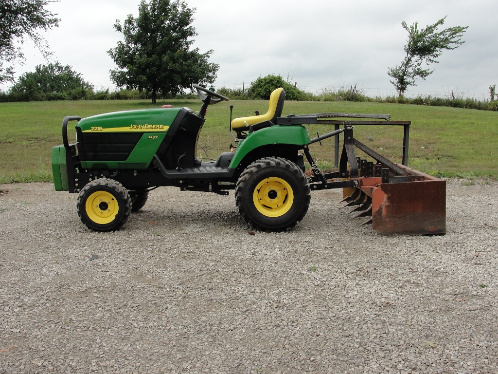

I also have a JD2210 and pull the heavy duty Frontier 60” BoxBlade. Works great and I maintain 4 miles of gravel road with it. I bought it new from JD dealer for about $800. I agree wider is better for getting passed mail boxes.

Excellent example. So if you want to blade next to an object you have to get your tire sidewall within 1/2" of the object?
Most 3pt hitches have some sideways play/adjustment. You can set the implement off to one side by at least a few inches.
The smaller blade will be easier to pull when it's loaded up with dirt. If you're not moving dirt like that, only grading a little off the top, you could use a wider blade.
Gearmore make some sturdy box blades, but they're sold mostly in the western US. I've been happy with both of the ones I've had.

I built a suitcase weight rack for the front of my JD2210. When using the BB I throw a couple weights on. If I begin spinning I pick up just a tad on the BB and no more spinning.
