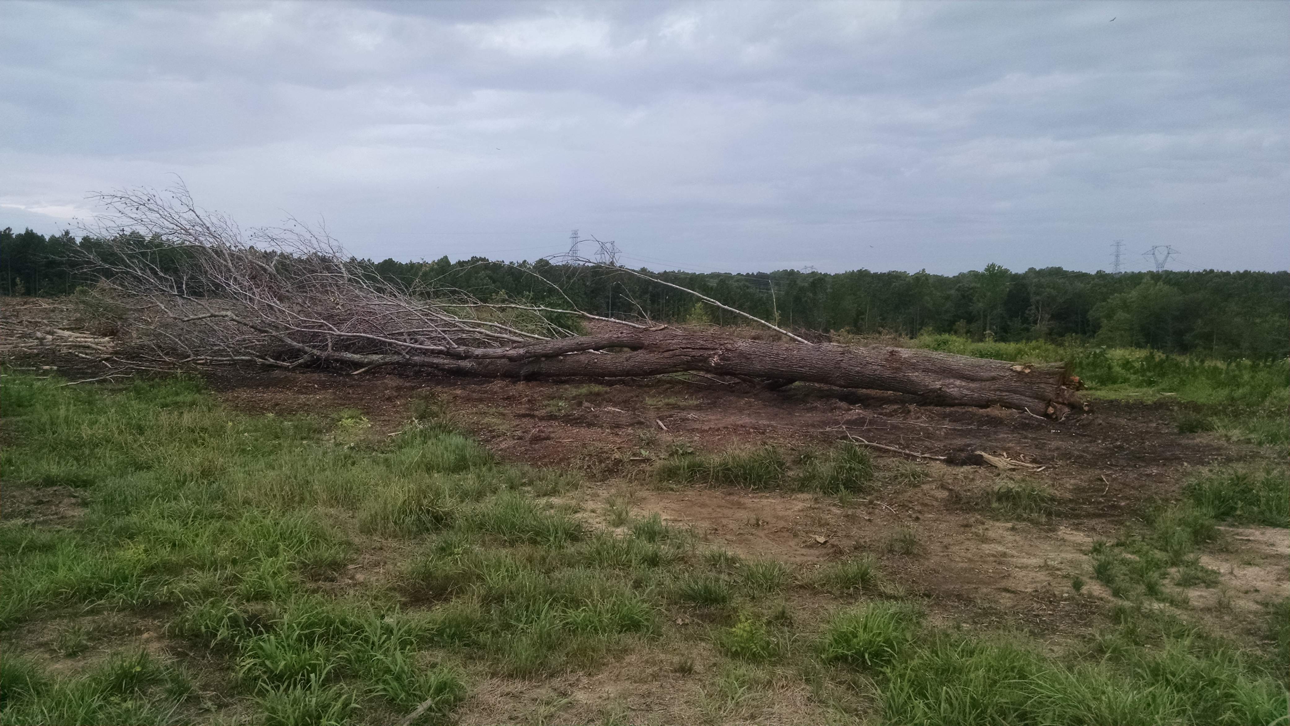

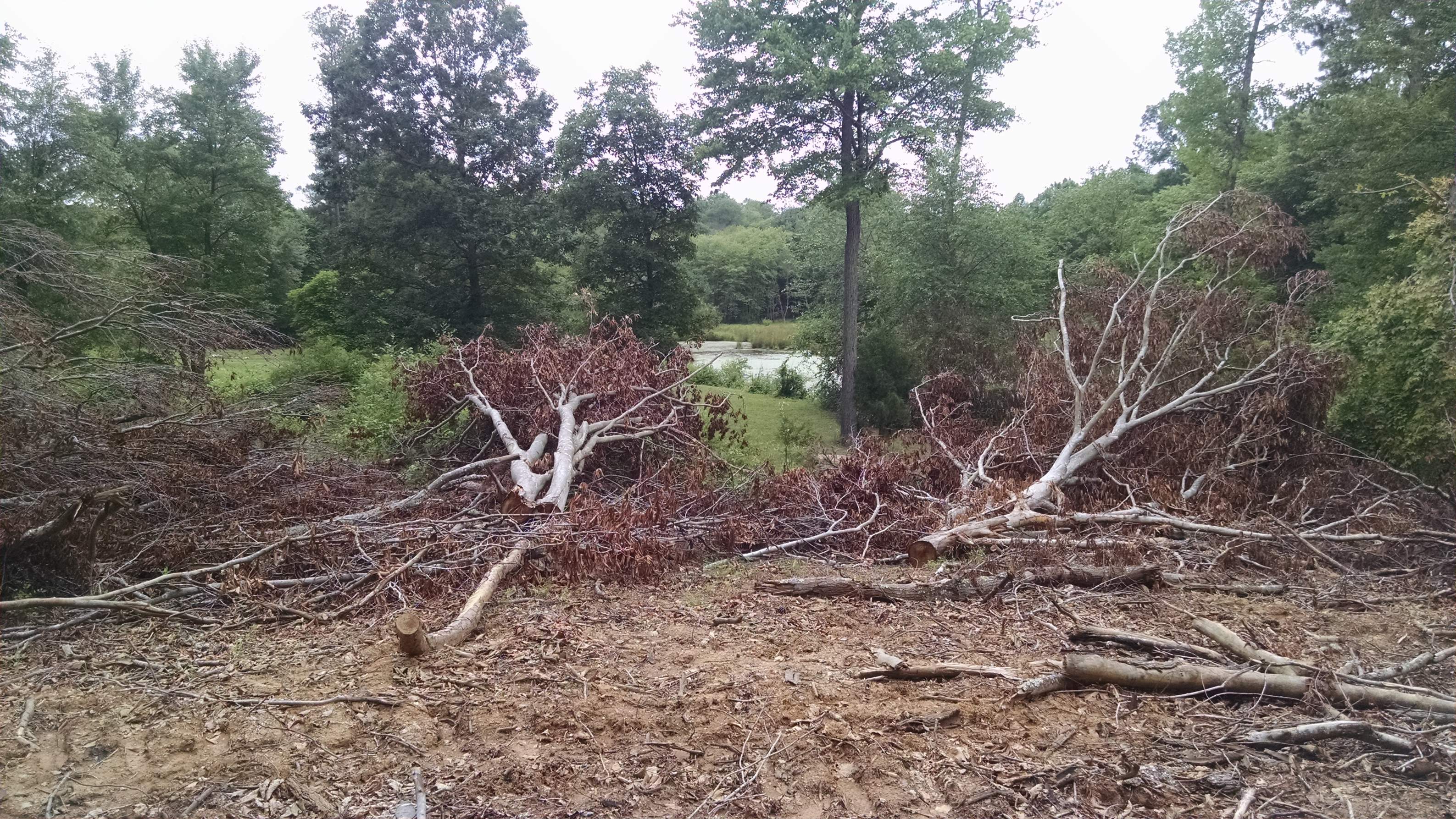

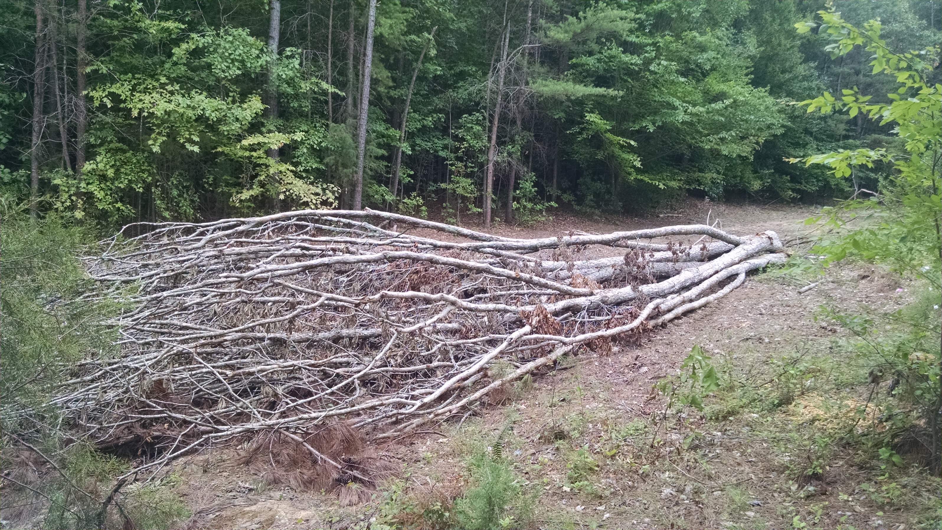

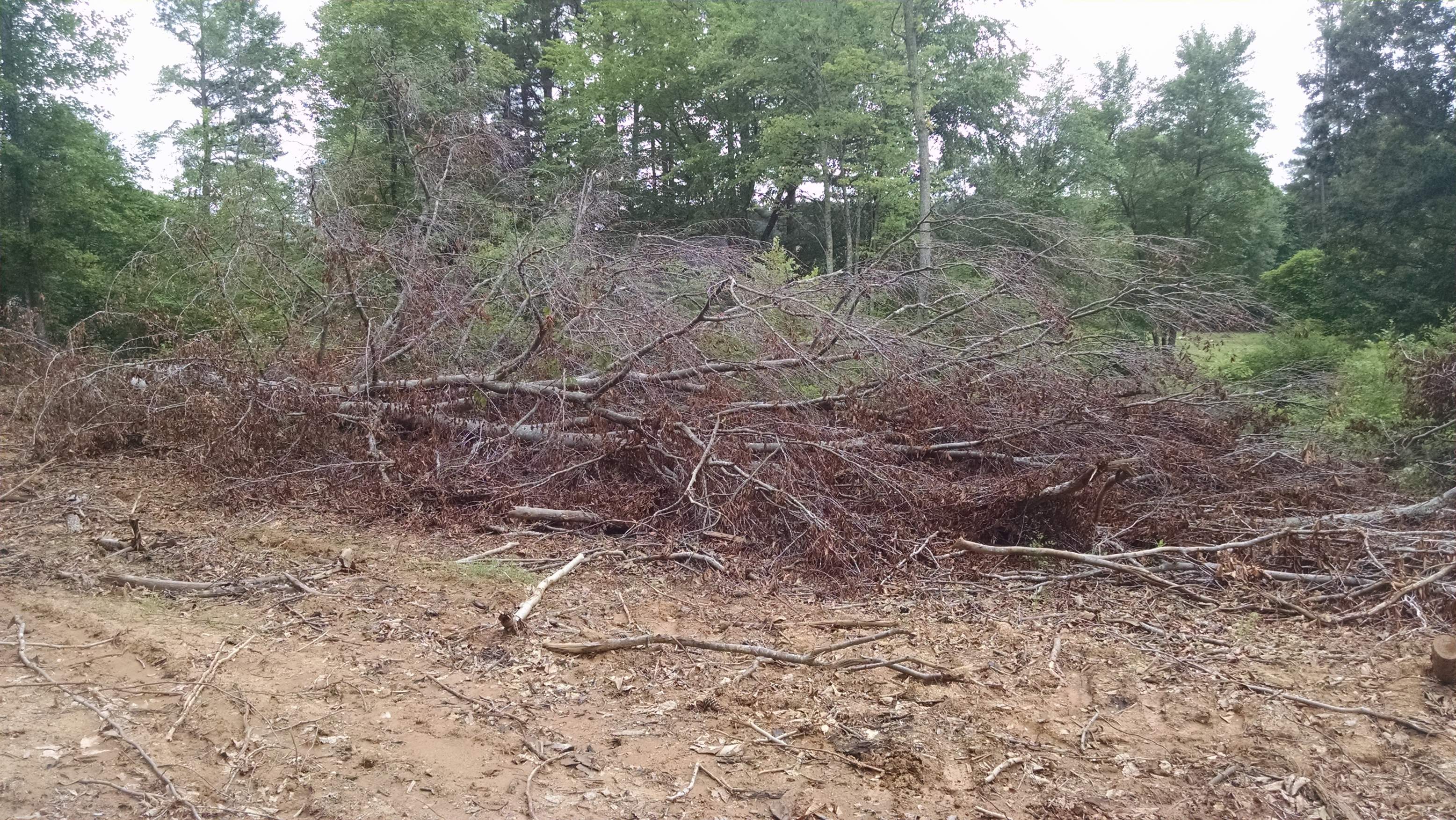

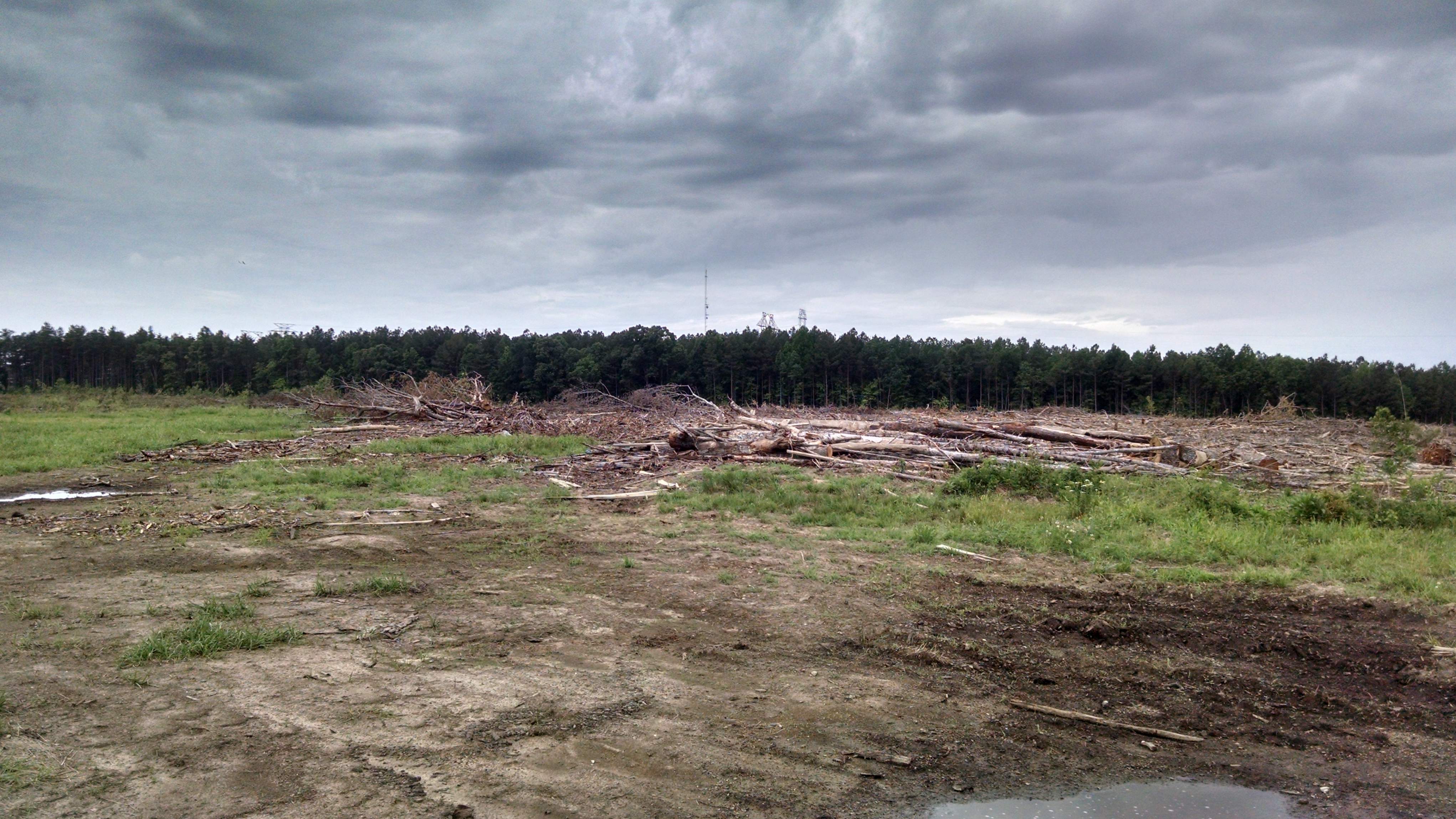

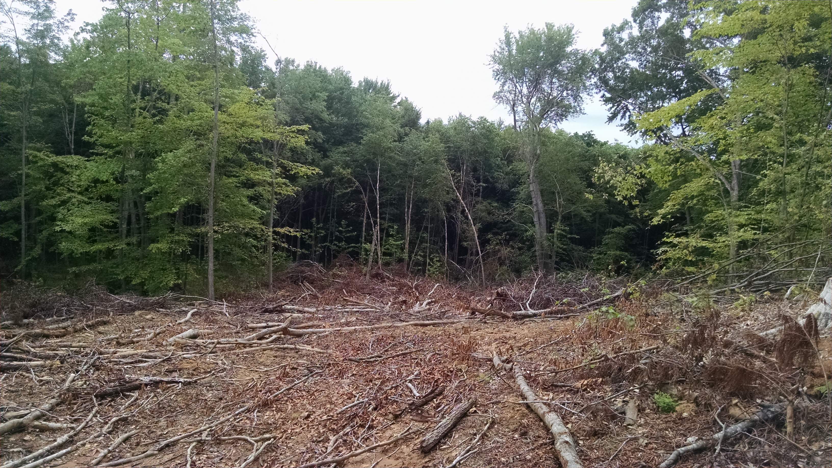

This is what I mean by limbing.
MOST of what I have to cut that is already on the ground is somewhere in one of those pics. Under the whole beech tree in Pic #4 there are at least 3 oak tops buried/behind it.

Here's the dilemma as I see it. You have a microburst of downed trees, partial trees and leaders, branches, scattered everywhere over a large plot of land. The stuff already on the ground has been there for some time and makes cleanup that much harder. Partly because the longer you leave leaders/trees etc. on the ground the harder it is to do cleanup. The branches get stiff vs. when freshly felled and dirt from rain is now on lots of the wood, making it tough on chain and bar, regardless of what saw you use.
I would not use a top handle saw on that project because of the inherent dangers of the saw's primary use, IN tree work, not for use on the ground due to the top handle design.
People can argue the point all day long, BUT the fact is you are way more likely to get hurt using that tool for your job.
What would I use? I would choose a saw like some of the ones mentioned by various people that have what I have. Possibly the MS180, MS 230 or 270. All are excellent saws, IMHO. All will get the job done.
I would see if I could start by narrowing down what you were going to burn and what to save for firewood. If possible, separate them out, and then go in and cut what needs to be cut. It would depend, for me on what the exact lot laid out like. I can't tell you by the pics where I would start, but I can tell you I'd do a through walk around before just jumping into the pile. One huge advantage I have is the log grapple I have shown in my avatar. It allows me to bring any size log, branch, entire tree to cutting height with little to no effort. It also allows me to get stuff off the ground to see where I can cut to avoid dirt, rocks etc.
You might consider renting one for a week or similar, or better yet buy one! They're cheap when it comes to saving one's back, and once you have one you'll never go back.
I'd be wearing steel toed logger boots, chaps, helmet with screen. AND I'd find some folks to remove what I cut, (ground crew) to stack what was to be burned, saved, etc.
You're safer with a crew than working alone, the work goes way faster and then it's done.
