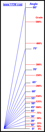

I am guessing that my angle is steeper than that but I don't know yet. Speaking of slope angles, what is the best way to figure out what my slope is? I have thought about using two levels, one horizontal and one vertical and measuring the distance between them on the ground and using a formula to figure out the angle. Is there an easier way?
Buy an inclinometer: https://www.google.com/search?q=inc....47827j0j7&sourceid=chrome&es_sm=122&ie=UTF-8

How to calculate: Gradient, Slope, Grade, Pitch, Rise Over Run Ratio Calculator

Thanks xfaxman. I never did quite understand when driving on the interstate and see a sign that said 5% grade the next 3 miles. I always thought about it being the same as 5 degrees and I knew 5 degrees was nowhere near as steep as the actual hill.
