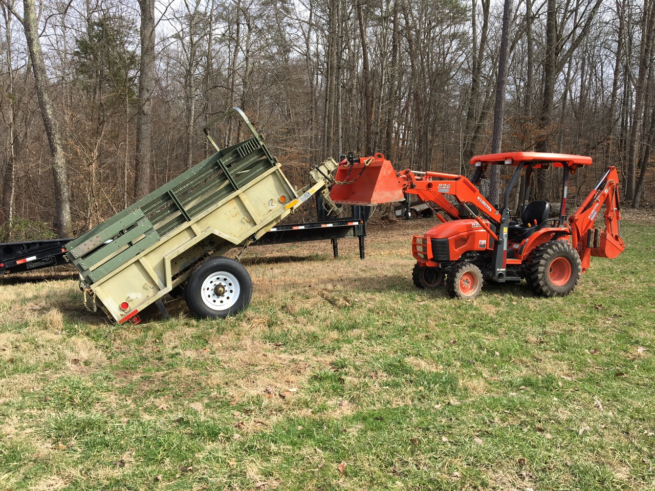

Army trailer?
Solid metal sides would contain a ton of stone.
Self contain surge brakes.
Separate mechanical brakes helps on farm.
Lunette hitch for better off road articulation.
Sideboards and canvas enclosure option.
I dump with the tractor. Some folks modify to dump mechanically.
Tow nicely on the road. Handles a full load of mulch to top of sideboards. Brakes are important.
Cheap. $500 years ago with 4 sideboards and full enclosure canvas. No rust. Had to wire for lights.
HD 16” wheels.
Some models have aluminum beds and run flat tires.

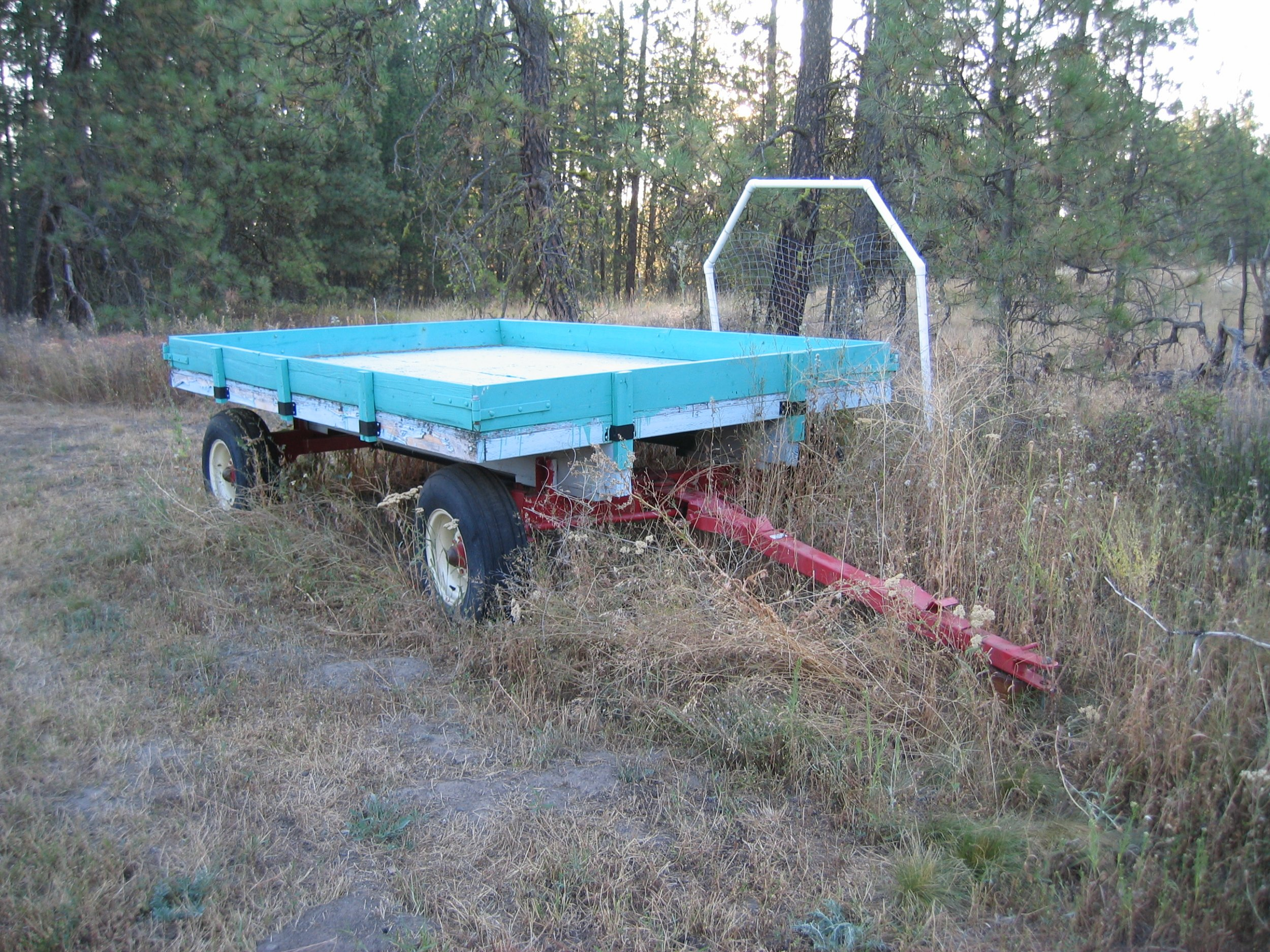

My trailer is not what you want - its a farm wagon. However - I bought brand new running gear from Horst and built this wagon to my exact needs. It's ten ton capacity. I carry large rock - large chunks of pine trunk and dirt & gravel. The build up is all wood. From the main beams to the floor to the sides.
Horst makes all types/models of running gear. If you are up to building your own. Mine took three days to assemble.

Army trailer?
HD 16” wheels.
