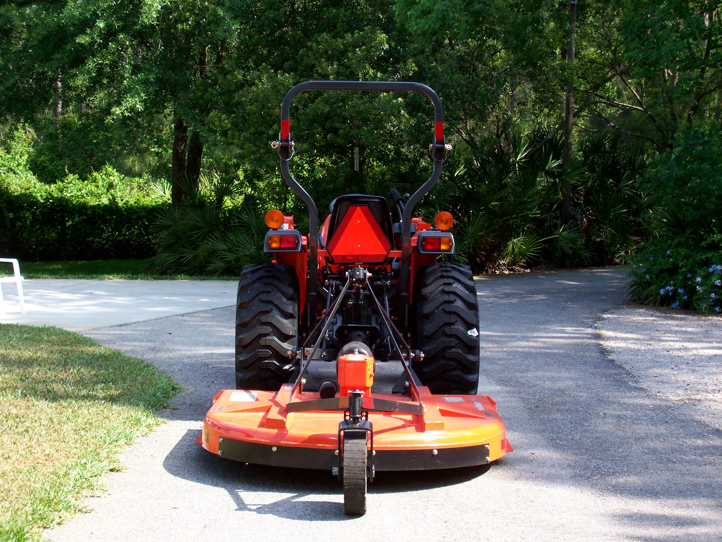

I have a Woods Heritage 60" (HSS60) and I gave it a good workout this weekend, starting to clear some hedgerows that consist of 1" to 3" trees and lots of brambles. What a beast! It chewed up everything I threw at it. I bought it more for this type of work than cutting any type of grass and so far my expectations have been far exceeded. I believe this is actually considered a light duty mower.
Todd
