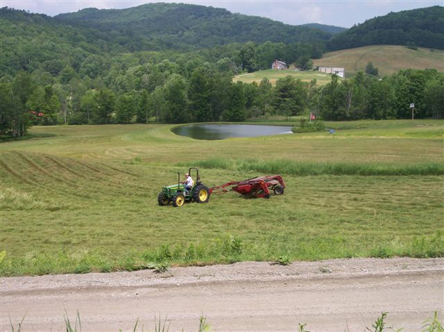

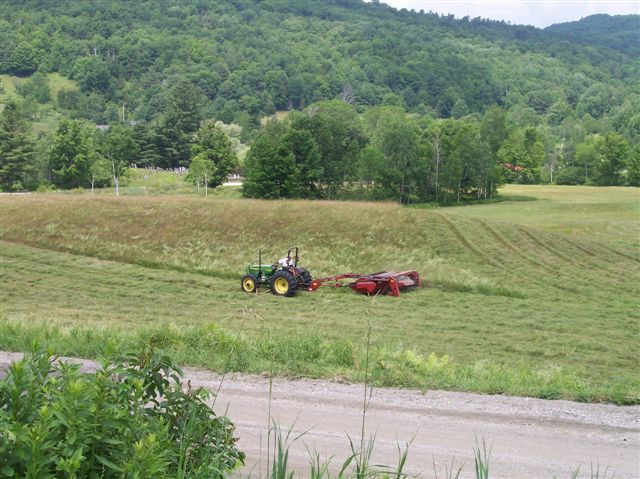

Good Mornin koerbdog,
As stated earlier in the thread, there are many tractors that fit the bill. My neighbor owns a JD 5105 FWD and does all his haying with this machine. Its in the 60 hp range, and he runs his 7 ft mower conditioner and his round baler on hills with no problems. A few years back he had a square baler with a kicker and towed a wagon behind that. When his wagon was fairly loaded it would push him around on the hills of Vt. Not a good feeling if youve ever done that sort of thing !
I want a mower conditioner and not a sickle bar.
I have been looking at mahindra and massey ferguson, but also like john deere's, any suggestions. Also looking at low profile tractors (with the belief that they have lower center of gravity and are thus more stable - would this be correct?). I plan to go with four wheel drive.
Thanks for the info!
As you probably allready know, a mower conditioner is nothing more than a sickle bar mower with crimping rollers to aid in drying the hay.
