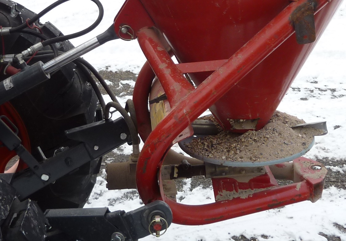

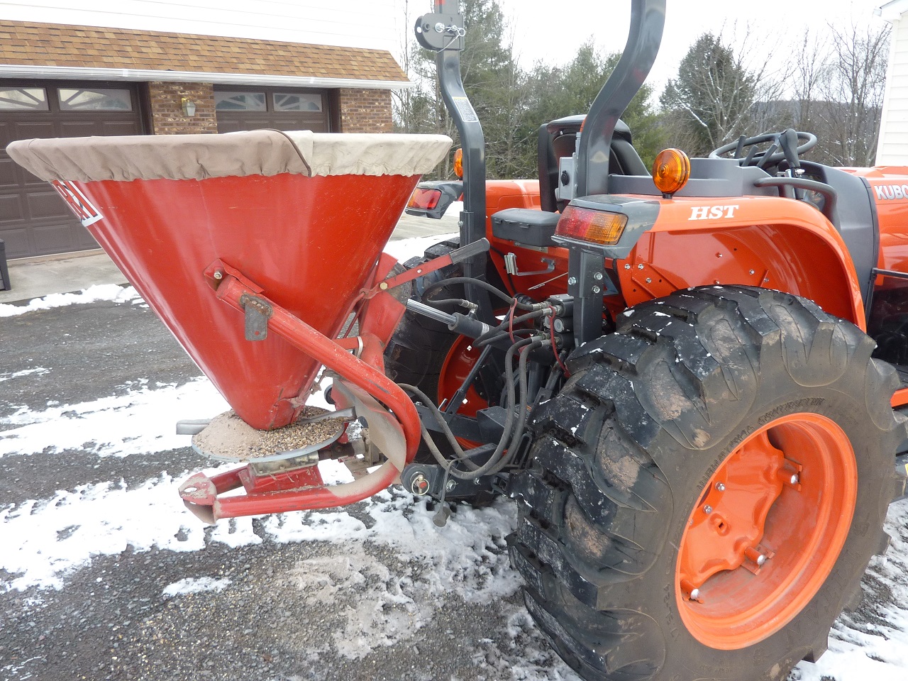

I found an old Fressori seed spreader on my dealers junk lot. I paid $50 for it since It was pretty rusty and missing the driveshaft. I painted it and even found the original decal. Instead of the PTO drive line, I installed a hydraulic motor and powered it from a rear remote.
I had to cut a second hole in the hopper to increase the material feed rate. I installed a flow restrictor in the hydraulic line to get the proper spin rate. I used a cheap outdoor fire pit cover for the hopper.
The rig works well for spreading sand and ash as long as it's dry.
View attachment 592988 View attachment 592989

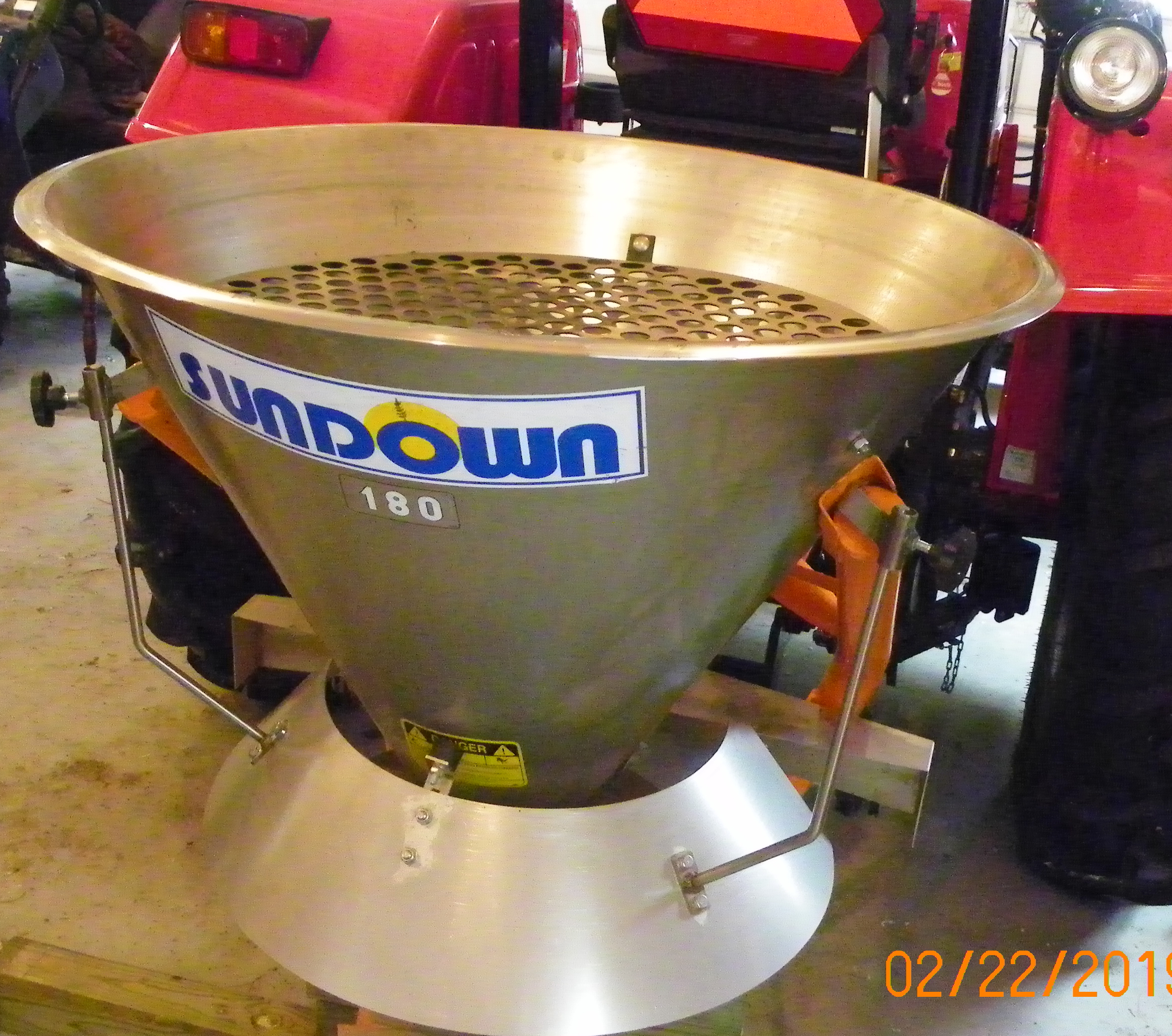

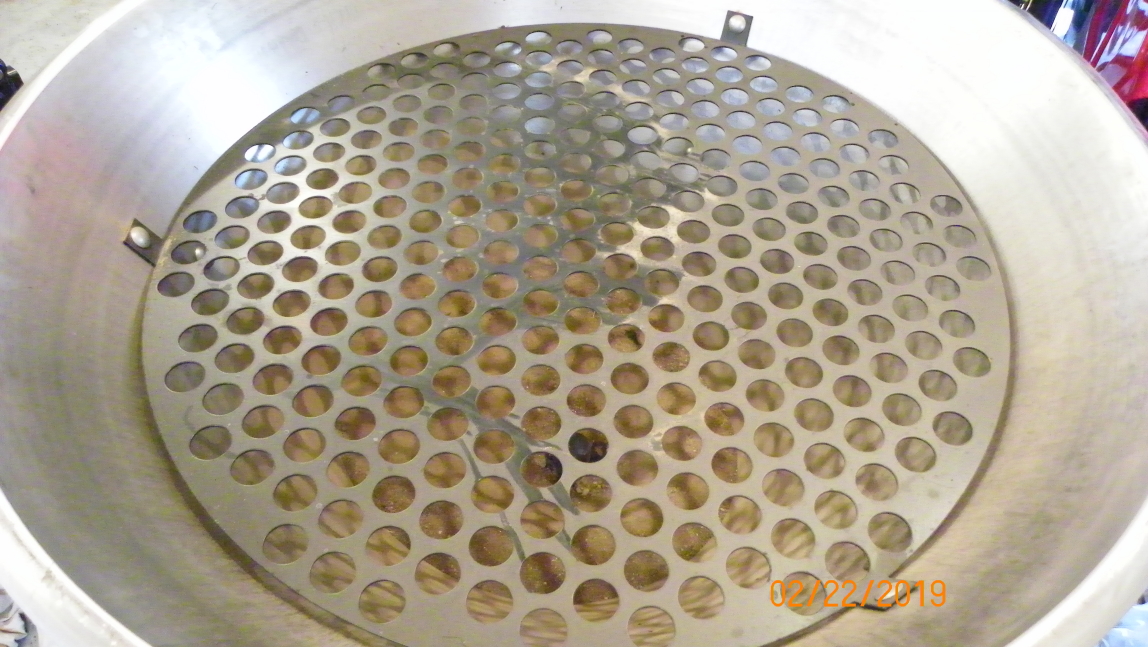

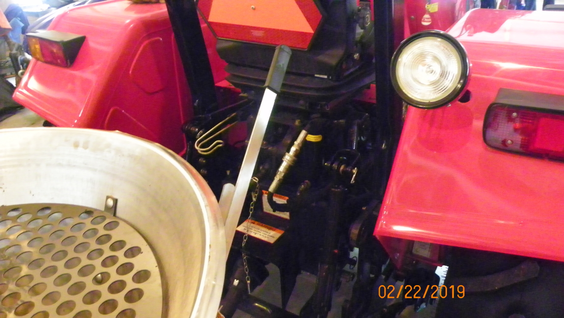

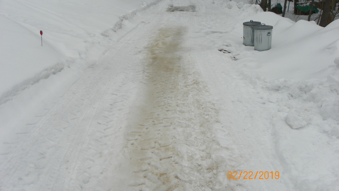

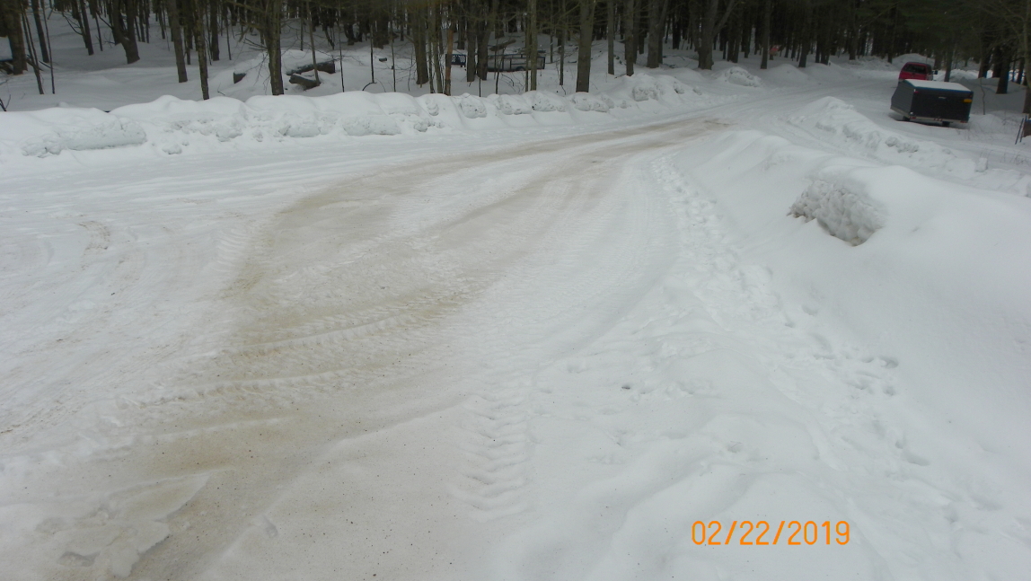

The Sundown 180 is all hooked up, I had the sand/salt shield down all the way but the next time I'll raise it so it will pretty much do the width of the driveway. It beats standing on the ice throwing sand on the driveway.
Just a few pictures of the 180 and the little bit I sanded.
