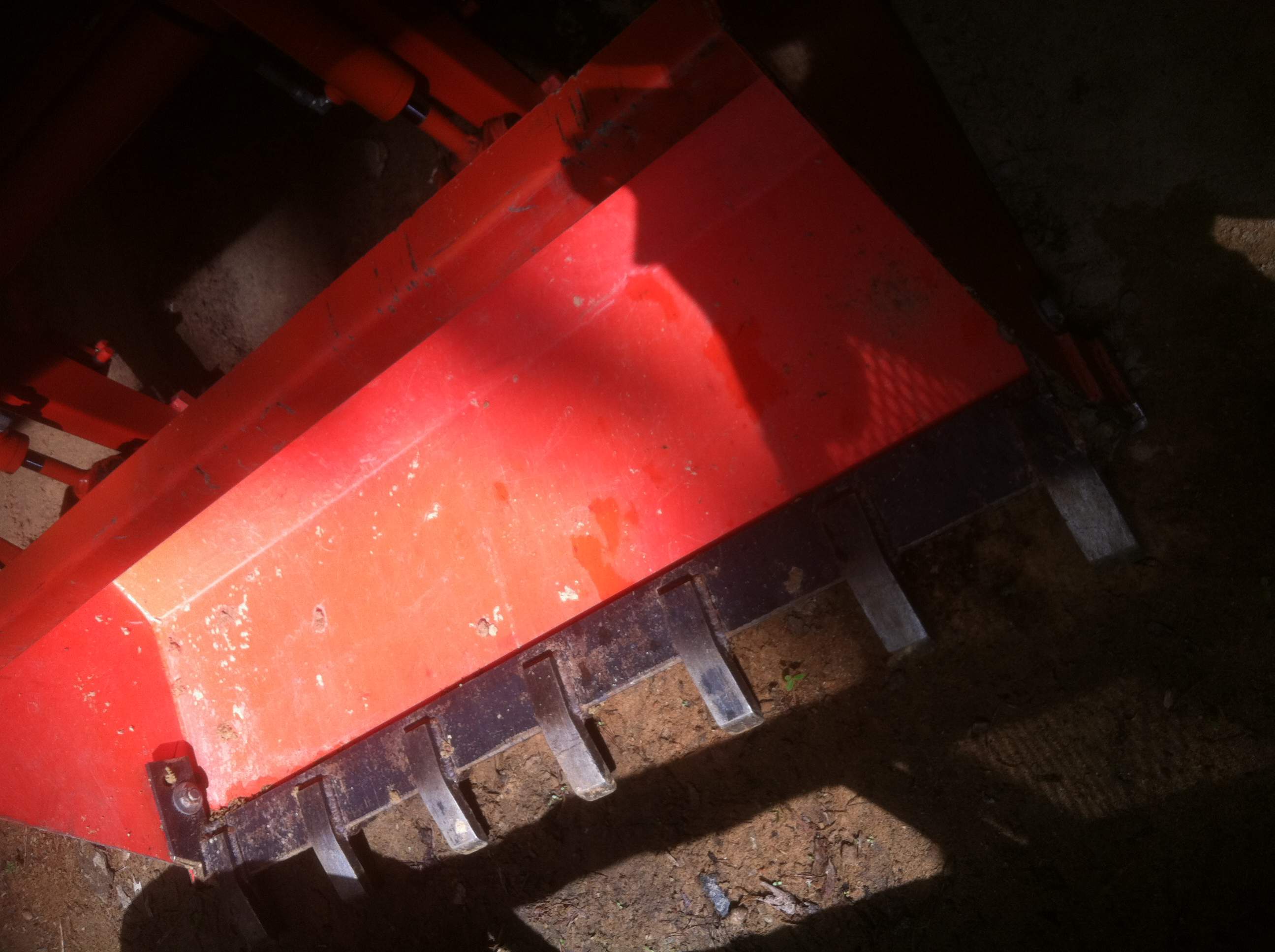

Hey Jim,
Sorry to hear about the bum deal on the toothbar. I would probably just build what you want. I used Fabco 2A teeth for the last one I built. I have one tooth left and it looks like it fits pretty nice on my new Kubota bucket. Someone is selling them on eBay, but wants about double they are worth. I bought mine locally along with a cutting edge. Here is a link from the Fabco website and a link to there page. The TB-8000 2A is the teeth I have/ had. I know you have probably already looked at these. Let me know if you want a picture on my bucket. I do not know when I will get around to building one. Good luck in whatever you decide.

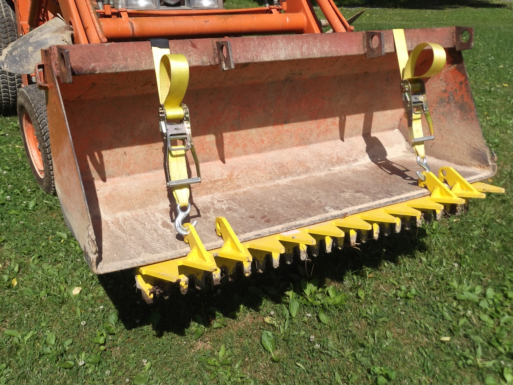

Check out Ratchet Rake, LLC - Rip and Dig, Tractor attachment, Bucket attachment, Loader, Skid loader, Kubota, Skid steer, Landscape rake, Brush remover, York Rake, Harley Rake, Rock Rake, Tractor rake attachment, Construction attachment, New Holland, Bobcat, . I use one on my Kubota 2500 and it works like a charm. On or off in about a minute and has never loosened during use. I clear brush, small trees and grass, level driveway, prepare garden plots. The thing works exactly like the site video shows. Best of all, it's very well made and costs less than any others I looked at.DSCF1185.JPGDSCF1185.JPG

Check out Ratchet Rake, LLC - Rip and Dig, Tractor attachment, Bucket attachment, Loader, Skid loader, Kubota, Skid steer, Landscape rake, Brush remover, York Rake, Harley Rake, Rock Rake, Tractor rake attachment, Construction attachment, New Holland, Bobcat, . I use one on my Kubota 2500 and it works like a charm. On or off in about a minute and has never loosened during use. I clear brush, small trees and grass, level driveway, prepare garden plots. The thing works exactly like the site video shows. Best of all, it's very well made and costs less than any others I looked at.View attachment 270959View attachment 270959
I like the Ratchet Rake - in fact I'm going to get one as soon as I can find my way up to the nearest TSC. The Ratchet Rake isn't much good for digging though - and that's what I wanted the toothbar for. I know the toothbar I had on my BX23's bucket helped quite a bit.

Thanks for the info - I will have to check out Fabco. I have seen the teeth for sale on Ebay - and you're right: they seem to sell them for a lot more than other places I have seen teeth advertised. Nice pic - that toothbar came out very nice. After thinking about this a little though - I've decided to find a 54" bucket for the LA504 on my tractor - and basically make the bucket into a "tooth bucket". The narrower width (from the 60" I have now) - will help with digging - and for about double the cost of a toothbar - I will have a separate bucket I can use just for digging. I've looked around and foiund some places selling AR400 - so I figure what I'll do is find some teeth that fit nicely on the bucket edge - and weld those on - and then also weld on some AR400 drag strips on teh bottom of the bucket and maybe one across the back edge.
Taking attachments on and off the FEL now that it has the Kubota QA setup on it - is great. I've been swapping back and forth between the bucket and pallet fork attachment for the last couple of weeks while I move rocks - and the QA feature makes life a lot easier. Swapping an entire bucket off using the QA - will be much easier than trying to bolt and unbolt a toothbar from the bucket.
