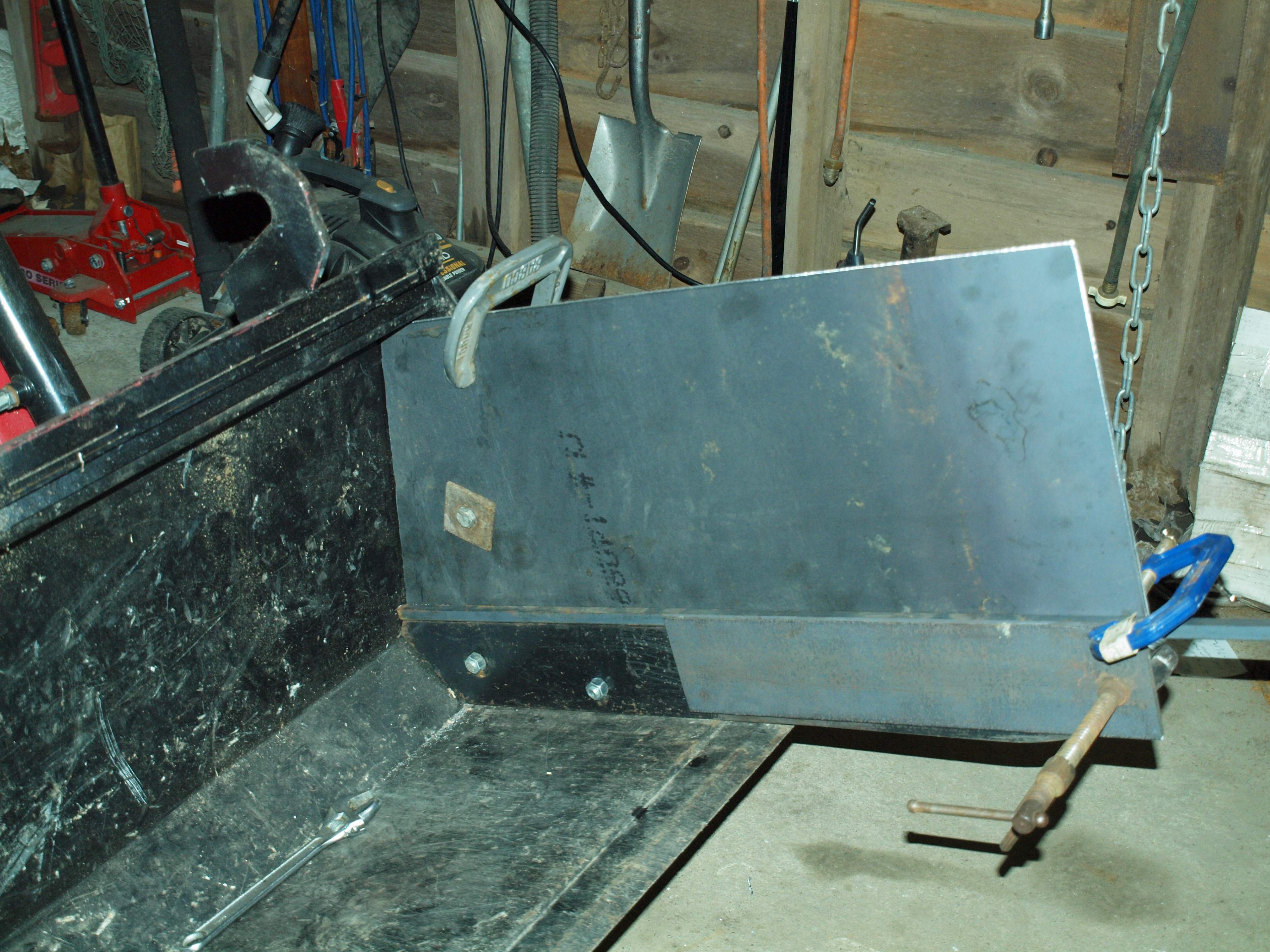

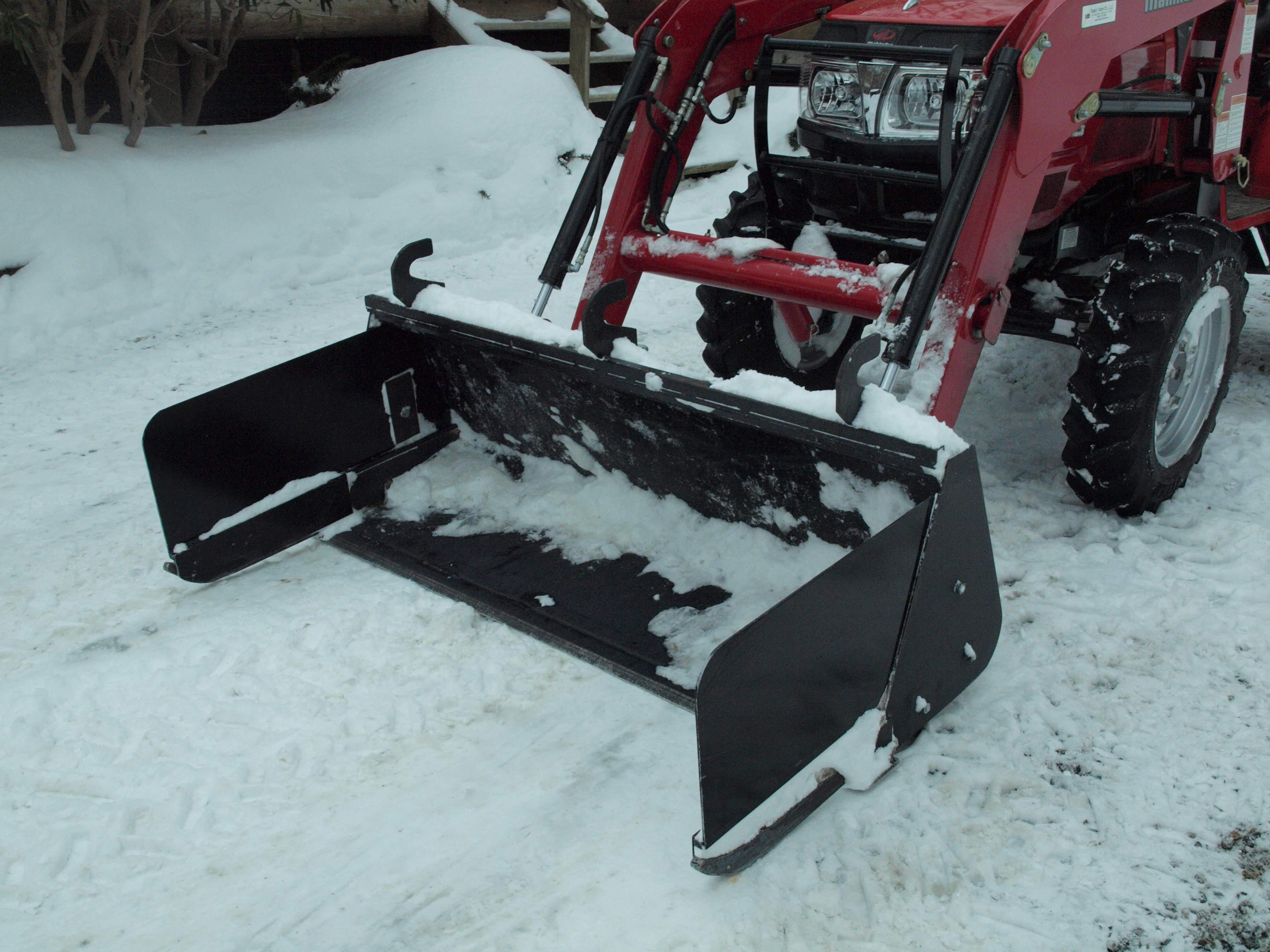

I use a rear blade and the bucket that came with the tractor (3016 which is same frame) I built up the sides of the bucket to make it act more like a snow pusher and it greatly reduced snow plowing time by a third to almost half depending on snow depth.
That is awesome that is what I need to do. What did you all use to make that work and how exactly did you do it.

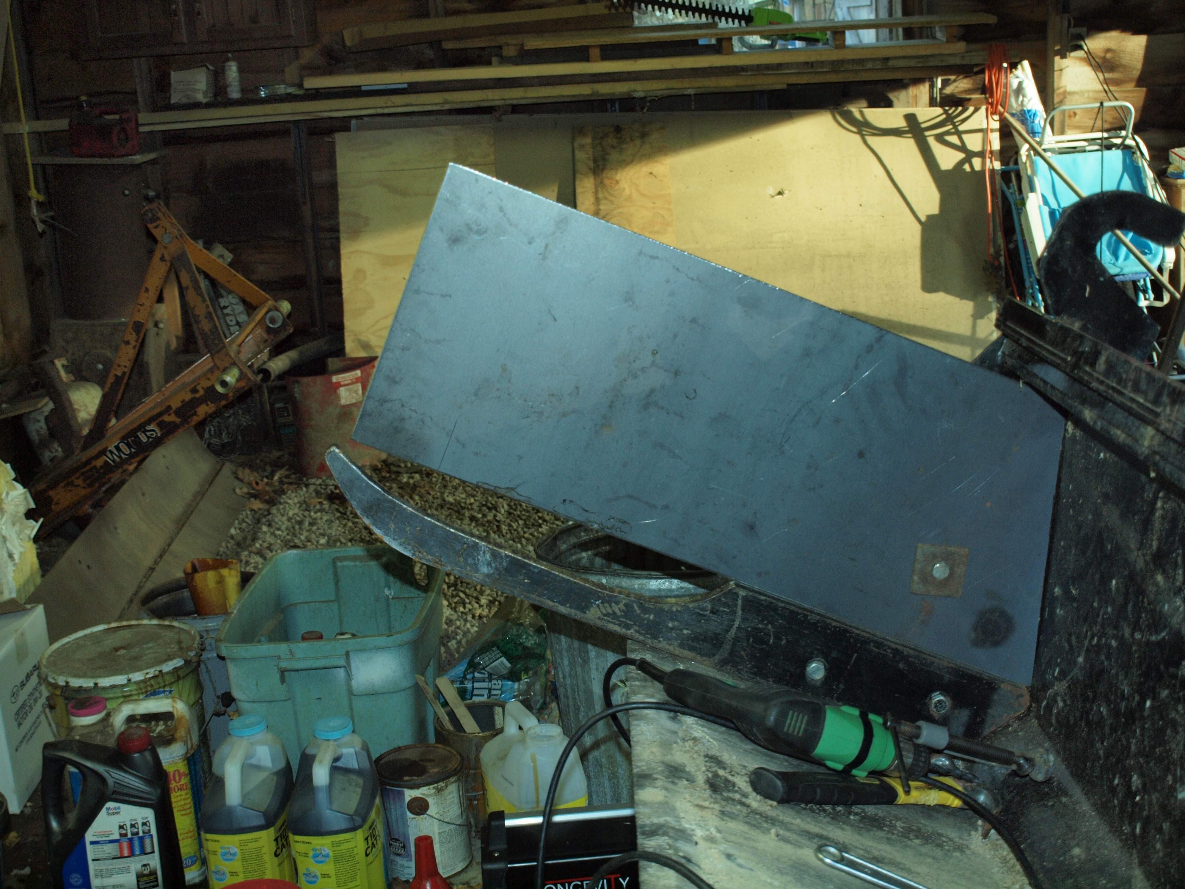

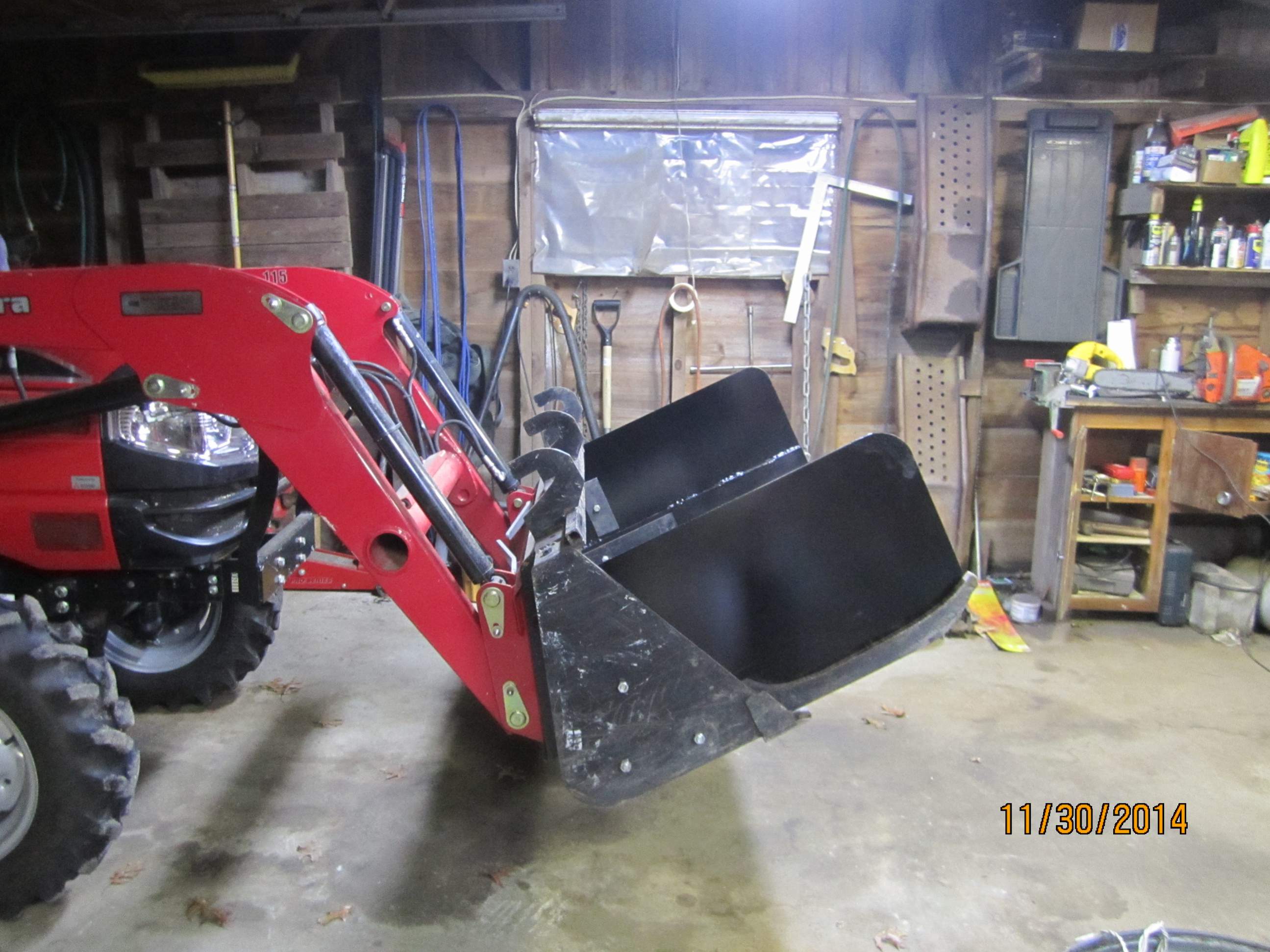

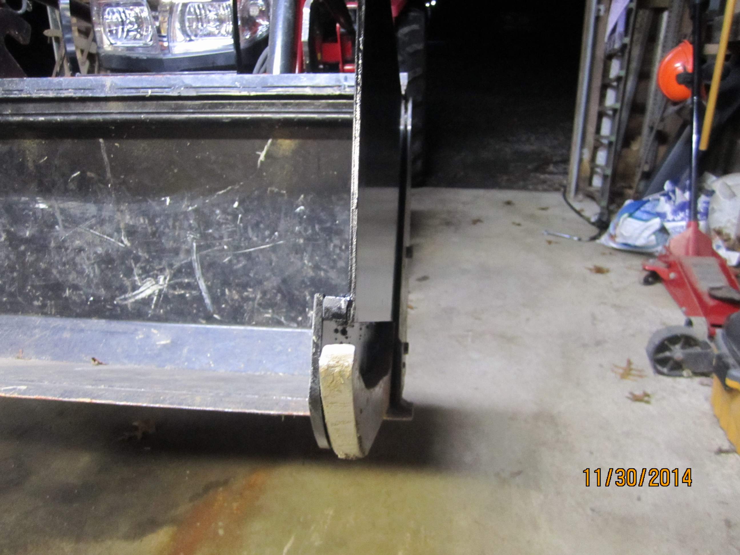

It is made out of 1/4" steel for the sides. It is supported by the 3/4" log hooks at the bottom because I do my logging in the winter and wanted something that would take less than 3 minutes to whip on and off. There was no deflection of the panels ever no matter what the snow depth (including the 25" drop). Here are pics describing build. Cost $40. Log hooks were $50 as I had them cut out. They are held on by one bolt per side.
