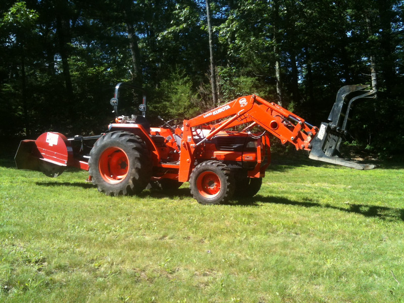

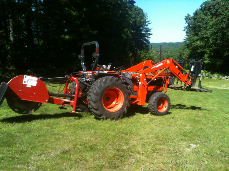

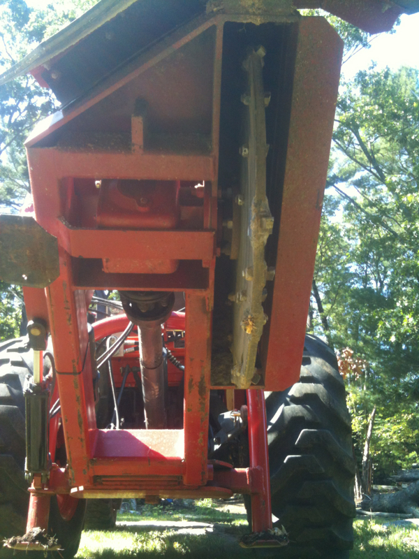

For 12"-14" stumps, and slash leftover from logging, you'd be amazed at how much you can cleanup with a setup like mine....
I can grind a 12" stump a foot below ground level in no time. How high are the stumps?
If I were in your situation, and the stumps really are that small, and I wanted to do it myself, I'd use just the setup I have now with the exception of if I were buying a tractor, and didn't already have one, I'd buy the next size up from mine and somewhere around 60PTO hp. Also, a skid plate of some sort would be almost required for logging cleanup.
I've done a lot of similar work as you describe, but on a much smaller scale, no where near 80 acres, but that isn't to say it can't be done, it would just take a long time.
If you want to make a lot of progress with affordable equipment, and minimal impact on the land, then the grapple setup on a good size tractor, and stump grinder on the back, would really do a lot for you.
