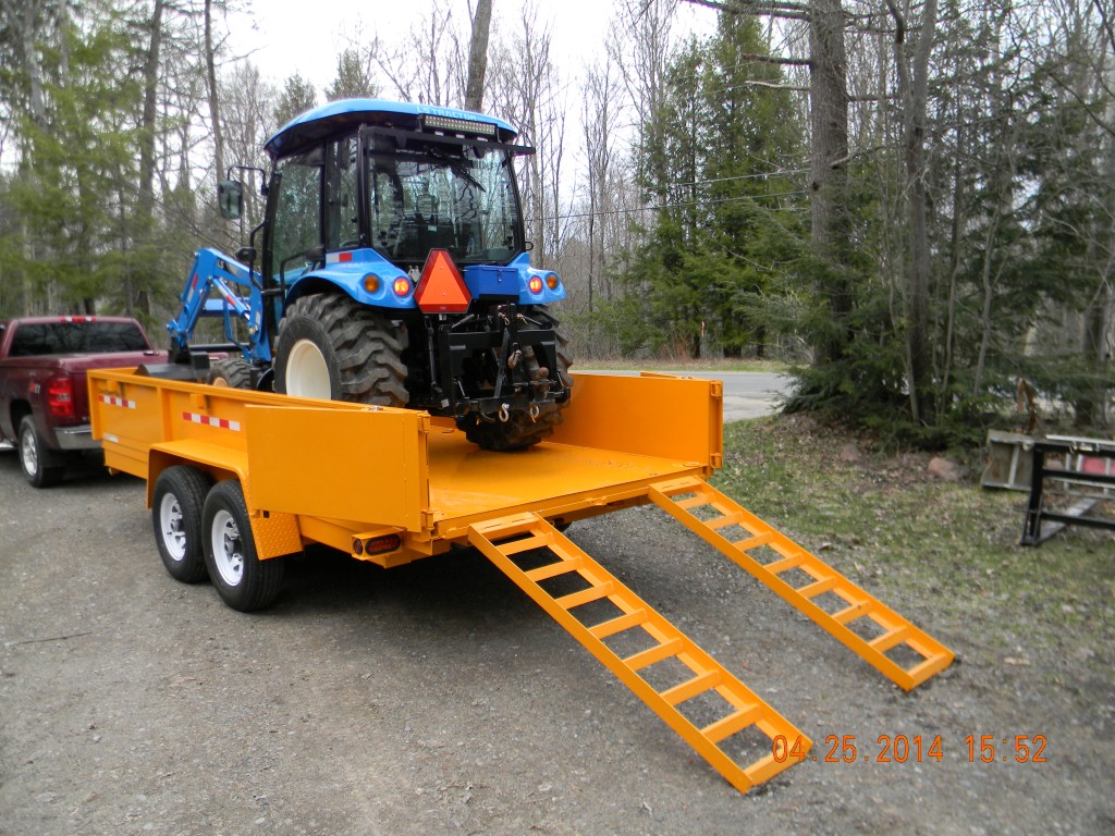

Greetings, I have a new Sure Trac 14' 14k lb dump trailer that's great, but the removable ramps are heavy on this old back. Looking for a set of high quality aluminum ramps in the 5,000 to 10,000lb (total) range (hauling a Kubota BX25D). I've found a few sets of nice ramps, however they have a bow to them (5-7" high at the center when placed on the ground) and won't fit into the trailer's ramps storage pockets. Anyone aware of a nice set of quality flat aluminum ramps?
Contact a Featherlite trailer dealer in your area, they build aluminum trailers and matching ramps which you can buy separately. My car hauler trailer I use for my tractor has flat all welded aluminum ramps that fit under the trailer. Looking at yours I am not sure they would be lighter as they are much beefier then the ladder ramps. Good Luck!
