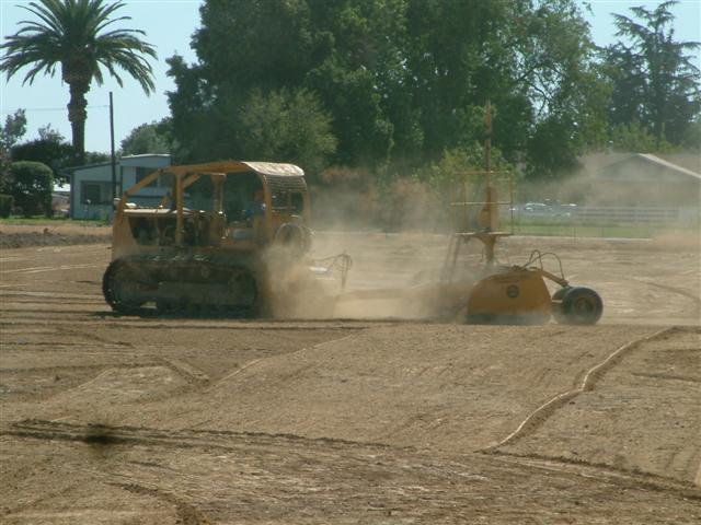

Have you considered construction equipment--my neighbor uses an old Cat D7 for leveling irrigated alfalfa fields. Something like that (with a bulldozer blade) would make the job go a lot faster

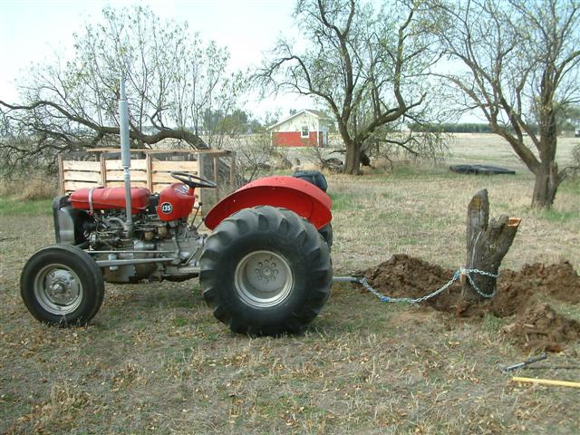

Your steep terrain is a safety problem with a tractor like the LX which is a general purpose utility tractor more suited to flat/moderately sloped topography. These tractors are not mountain goats. So be careful. Don't know how steep is steep in your case, but I'd consider some type of modified tractor set up for steep slopes--like my 1964 Massey Ferguson 135 diesel which has been modified to squat low for work in the olive orchards around my place.
This 135 is a field tractor modified by switching from 28" diameter rear rims to 16" diameter rims to handle those wide 18.6-16A tires and installing shorter spindles on the front axle to keep the tractor level.
Whatever you decide, be careful out there.
