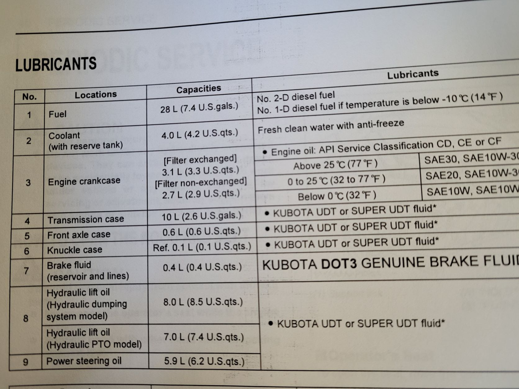

I have a 2009 Kubota RTV 900, and I'm currently doing some routine maintenance ie. engine oil and filter change, air filter (inner and outer) cartridges, transmission fluid and filter, engine coolant check and lastly, the hydraulic oil & filter for the bed lift. Since that oil only powers that single lift cylinder (I think?), does that need to be the expensive UDT2 Hydraulic / HST fluid? Or would a regular hydraulic oil suffice, like the Standard UDT hyd fluid. Thanks

I think you could use any universal hydraulic oil. But here's what my manual says.
Thanks Richard. I bought my RTV used, and no manuals came with it. I've got to go on line and get an owners manual. Thanks for your reply.

Thanks for your reply. As I said in my original post, I was thinking of using Kubota Standard UDT, as opposed to the Super UDT2. Both are Kubota products. I just wasn't sure if UDT was recommended by Kubota for the bed lift cylinder and pump, but since Richard posted a copy of Kubota's recommended fluids for the RTV900, it clearly shows the standard UDT fluid is acceptable. Just being frugal, I guess. $12 difference between the 2 grades of fluids. Not sure of viscosity ratings, but if Kubota says it's OK and they don't show any temperature stipulations, I think I'll go with the Standard UDT. Thanks
