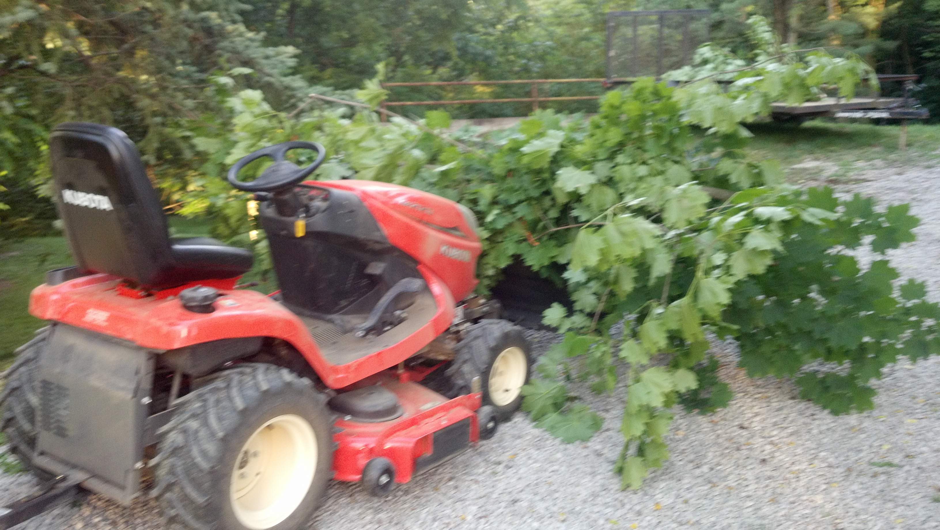

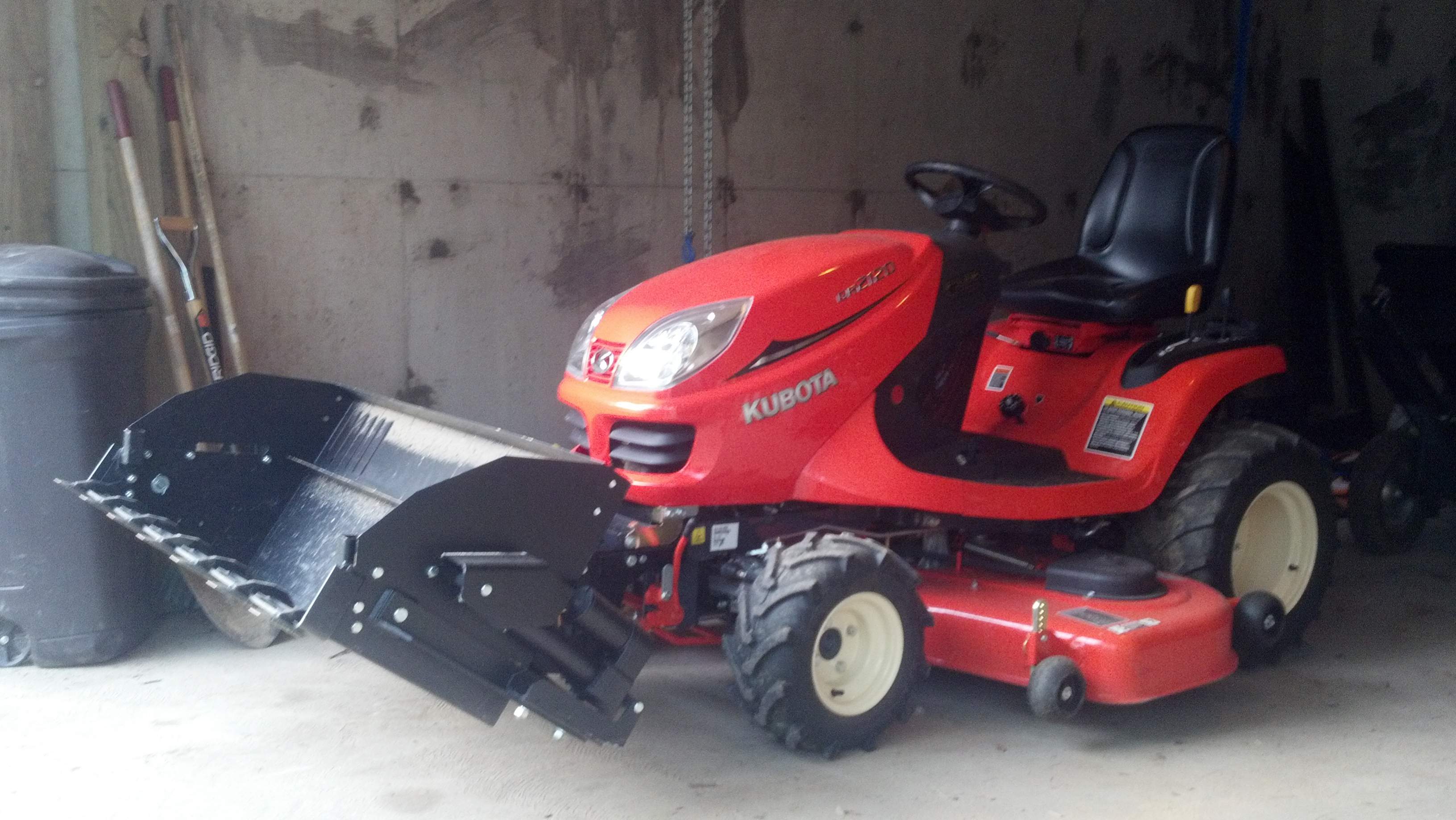

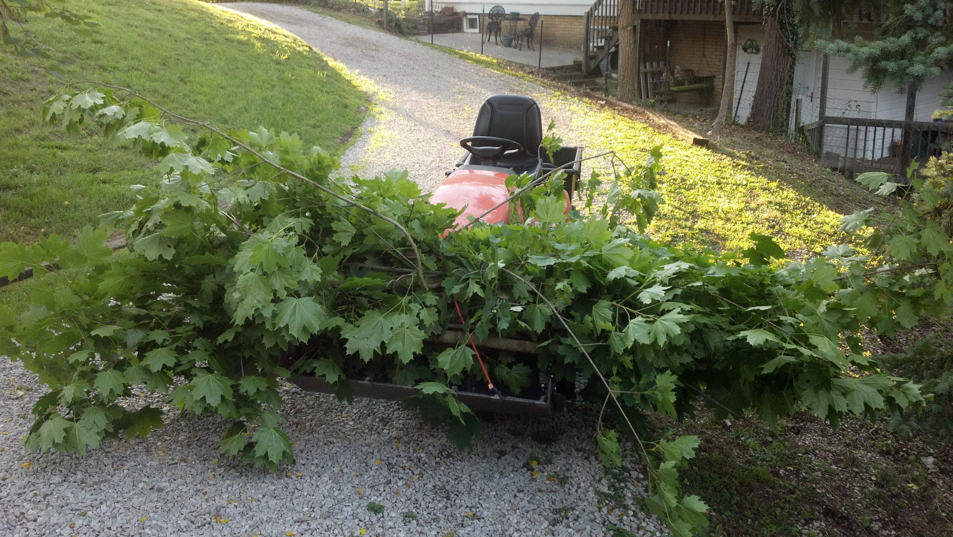

2012-06-12_19-53-10_556.jpg2012-06-12_19-53-29_183.jpg2012-05-30_07-12-28_27.jpgWell, its been a full season of use, 45 hours, for the GR2120. It's our first year at a property that needed, and still needs, some work and attention. The 54" mower deck has been great and reduced mowing time significantly. What once was a 1.5 hr+ job of hanging and sliding has turned into speedy 1 hr cut. The speed of the machine, coupled with the climbing and steering control has made mowing quite enjoyable. I hit the small hillside about twice a month during the summer and the grip of the machine has significantly reduced tire damage to the turf. The mulching kit has been great. Grass clipping have rarely ever clumped in the yard. Also, it recently did a fine job when I simply put the deck around 3-3.5" to mulch the leaves. I have been very satisfied with the mower, and setting it at 2.75"-3" has been a lot more healthy for the grass.

The Johnny Bucket Jr. has made yard waste removal really simple and I leave it on all the time. It reduces some maneuverability around the house and the approach to trees, but I always have a reason to haul things around. The "caddy arms" have proven to be of great use. Tree limbs can easily be tossed on and strapped with a simple bungee cord.(see pics) I have moved massive amounts of fallen debris and its much more stable than a trailer. Using a combination 10 cu. ft. trailer for small leaves and sticks and using the caddy arms for hauling limbs has proven to make this unit a sleek tree cleanup machine. The summer storms gave me plenty of work this year and I have received compliments on the setup from neighbors. I used the JBjr and a chainsaw to clear the whole street of limbs from one massive storm. Also, the tooth bar on the JBjr cleaned up our gravel driveway going to the lower garage. I thought I needed gravel but went ahead and back-dragged the whole thing and it looked like new. You can't lift much weight with it. I have moved many heavy stones around and you really have to just make more runs and not pile up a lot of them into one scoop. Back-dragging was also an effective way of smoothing out a hillside of soil from last years garage construction. The bucket worked pretty well, but a little more machine would have benefited. Although, I doubt a bigger machine could really get back to that spot without causing other damage.
I'm a happy customer so far. The Johnny Bucket Jr. attachment should keep this machine useful this fall and winter. I have so much work to do around the property and it fits just right for the lawn, hills, and trees of our acre sitting over top a southern Ohio town.
