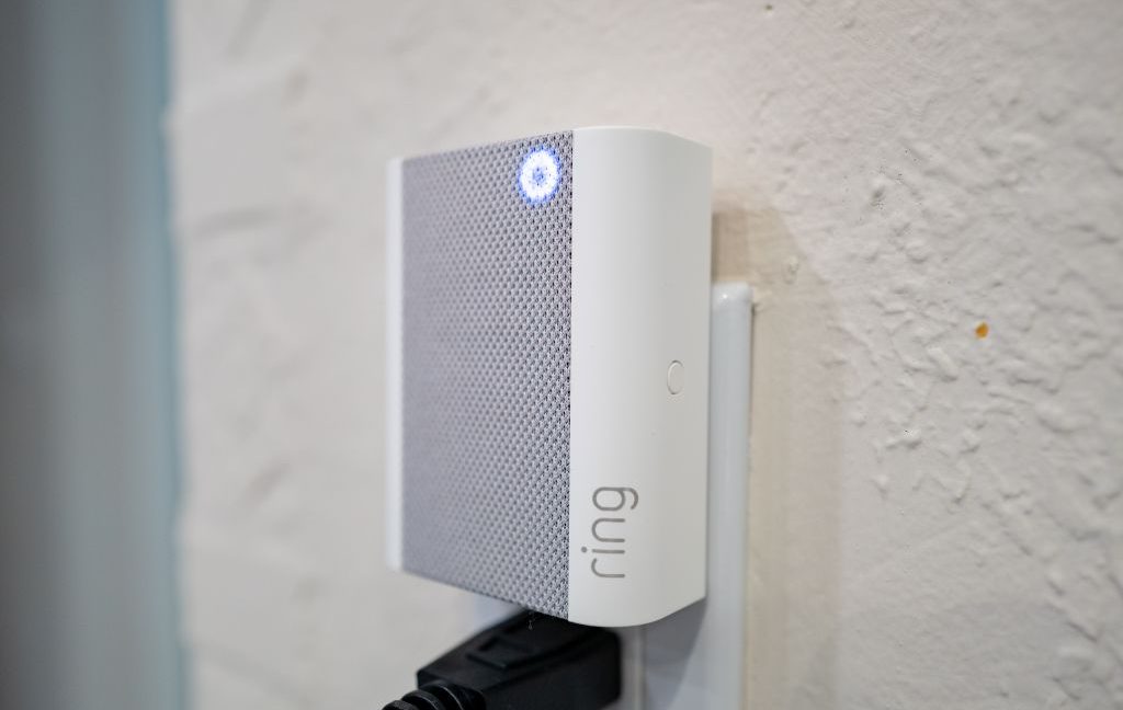

I was told earlier that Ring doorbell cameras store 100% of the video footage on their servers whether you subscribe to their cloud service or not. So, they keep videos of your property you may not know even exist.
Related, I was told there is history that Ring has turned such videos over to law enforcement for prosecution even if the person being prosecuted was the customer who originally bought the Ring doorbell. If that is true it is the ultimate "snitch" machine. 😃
I don't know if that is an internet rumor or something valid, but it did come to me from several sources.
I think that the story is a little complicated. Amazon (Ring) did share customer videos after being served with search warrants with some time pressure. In the cases that were reported, the customers were storing the video on Ring's (Amazon's) servers.
Separately, I believe that Nest did reserve the right to upload video for a variety of purposes in the early days, but the current privacy document seems to suggest that it only happens if you turn on features that require notifications, and thus analysis by Google;
They have gone on record saying that they have never turned over video to law enforcement without a warrant.
