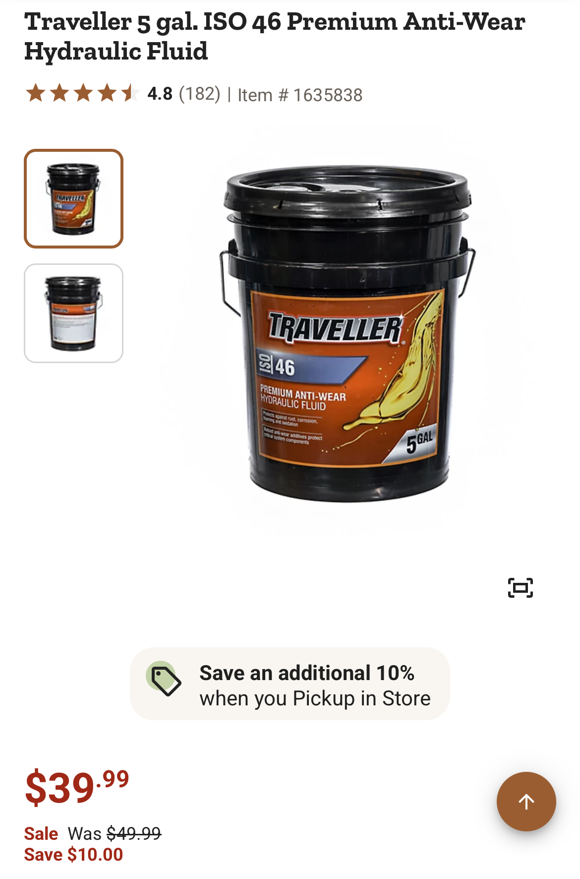

On sale this week for 39.99.
Think I’ll pick up a pail of it, tomorrow. Maybe 2.

Yeah the stinky stuff. I’ve seen it in front axles but not hydraulic systems who calls for gl4 spec for hydraulics?
TSC AW46 is GL-4. I have emailed my contact at mobil through work to get some answers on Delvac. TYM does and probalby all the brands built by TYM do
   / Looking for inexpensive AW46 - Hydraulic Oil #103
Again..You, or someone taking to you , is confusing their Premium Tractor Fluid, which DOES meet the GL-4 gear spec, with their cheaper ISO-46 hydraulic fluid, which DOES NOT.
   / Looking for inexpensive AW46 - Hydraulic Oil #104
No.
I am not confused. I checked with TSC. I also emailed my ExxonMobil rep through work. This is stuff I actually do for a living unlike most of the retired keyboard warriors on here. 30 years in industrial maintenance and engineering. ExxonMobil confirmed mobilfluid 424 and Delvac are the same and both meet GL4. They are slightly thicker than AW46. For a lighter option they have Mobilfluid LT which is roughly ISO VG 32.
   / Looking for inexpensive AW46 - Hydraulic Oil #105
No.
Yes, yes you ARE confused..still.
Mobil 424, and Delvac are Tractor/transmission hydraulic fluids, thus meet the GL4 specification, as does Tractor supply Premium Tractor /transmission fluid.
For the third time…inexpensive Tractor supply ISO 46 Premium hydraulic fluid IS NOT for use with gears, transmissions or wet clutches /brakes, and does NOT meet the GL-4 gear spec.
What is so difficult for you to understand about that?
I’m not debating something this ridiculous with you anymore.
Feel free to post a photo of where Tractor supply states their $40 ISO 46 hydraulic oil meets GL-4 specification….
I’m done .
