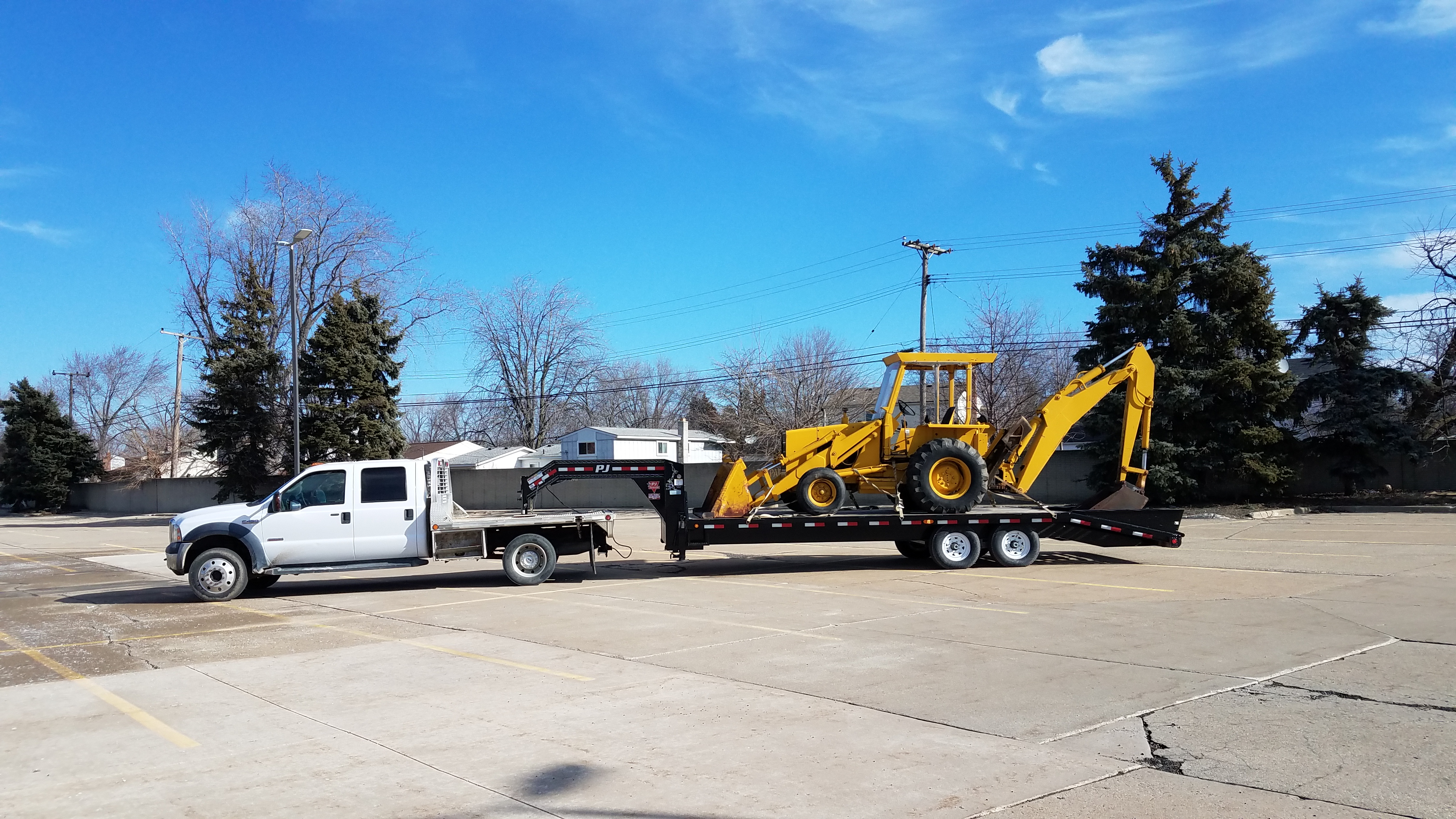

Well I was able to get her started again, filled up all the tires as they had leaked down a bit, and loaded her onto the trailer. I was able to load her going forward, it wasn't too bad after all. I just took it slowly in first gear and she climbed up no problem. Now for the ride home and getting her back to the little farm.
At least now that she'll be back at my place, I can start to do some more work to her as time permits.

That machine is a lucky find!
I assume that you were only trailering a short distance, but nylon straps are not adequate.
For your safety, and the safety of others, please get some chains, and binders, next time you need to trailer the machine.
Your PJ gooseneck looks great!

Thank you! Yes, I completely agree on the straps. This is a temporary one time haul for the time being. Drove slow and extra careful and made it home safely.
