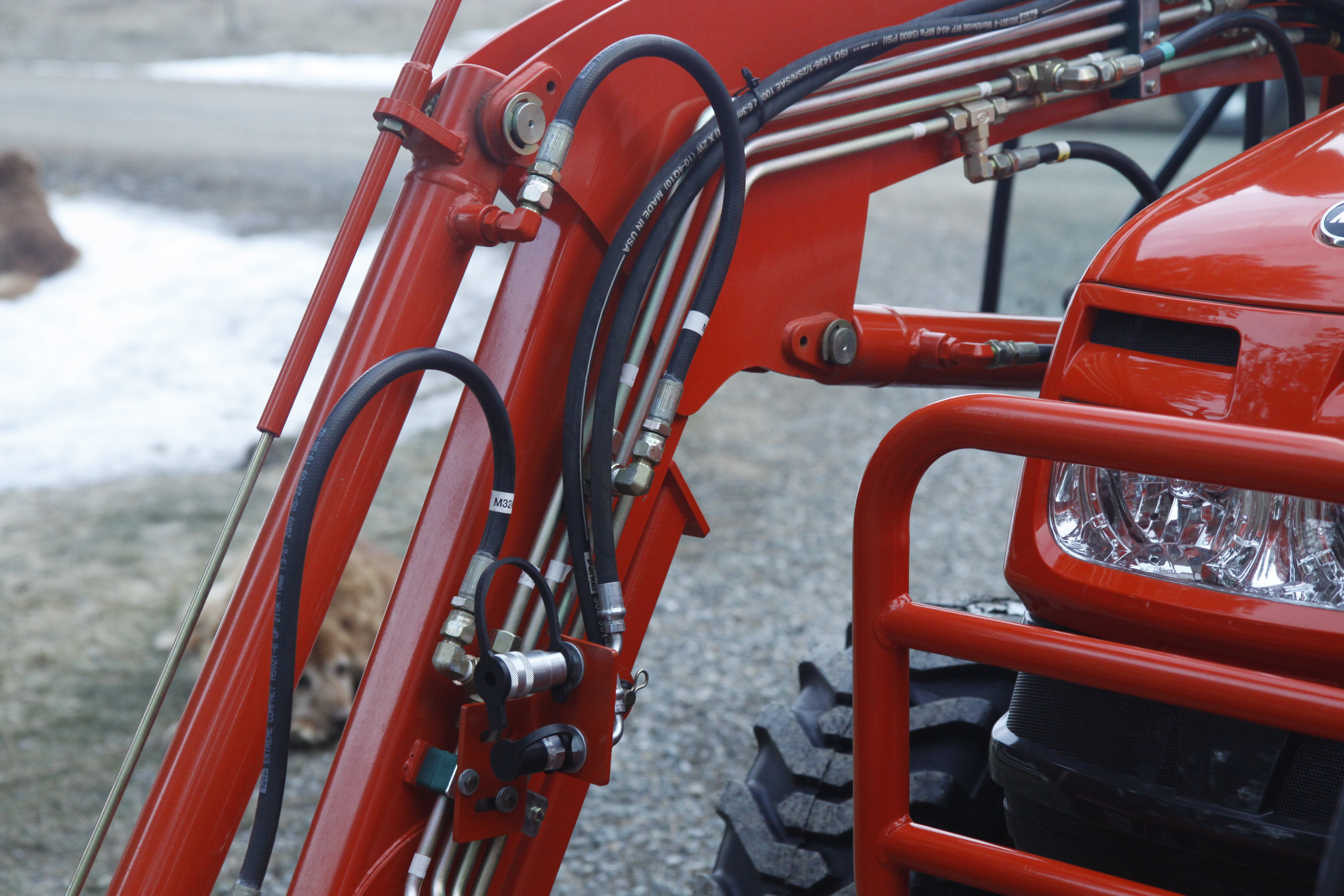

I had dealer install a bracket mounted set of hydraulic hoses on arm next to bucket and run a set of hoses to rear remotes. I simply remove bucket, hook up plow and plug in 2 6foot hoses from plow. All told, about 2 minutes work _MG_4744.JPG and it runs under tractor with another set of quick connects under tractor so the hose can be split if i remove loader. then attaches to rear remote. hose2.jpg this was added for $400 at time of purchase. it was less than 1/2 the cost of 3rd function. more than likely, if i were to purchase the unit today, i would have added the 3rd function. but thisd works great for me. its plugged into the 2nd rear remote that does not have a detent on control.
Nice!
