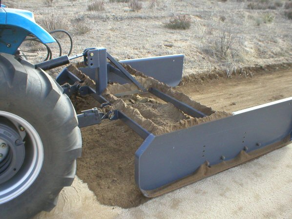

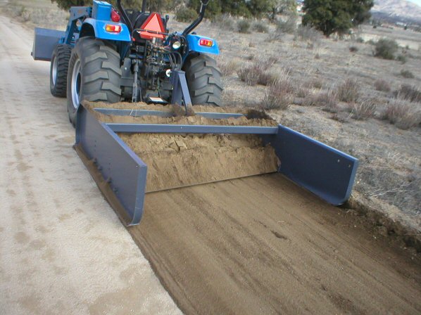

There is just no implement that will do it all. With as much road work that you are going to need to do, I would really think about a road grader blade. I usually recommend either one of these.
Road Boss Grader - Road and Landscape Grading, Surfacing and Leveling, and Material Spreading and Reclamation Or GradeMaster Grader Blades
I maintain a couple of miles of roads and have 4 different implements that I use. But if I was to only have one to maintain the roads, a road grader blade is what I would prefer to have.
One last thing, with the size of your tractor, any of these implements that you are considering should weigh a minimum of 1000lbs.
