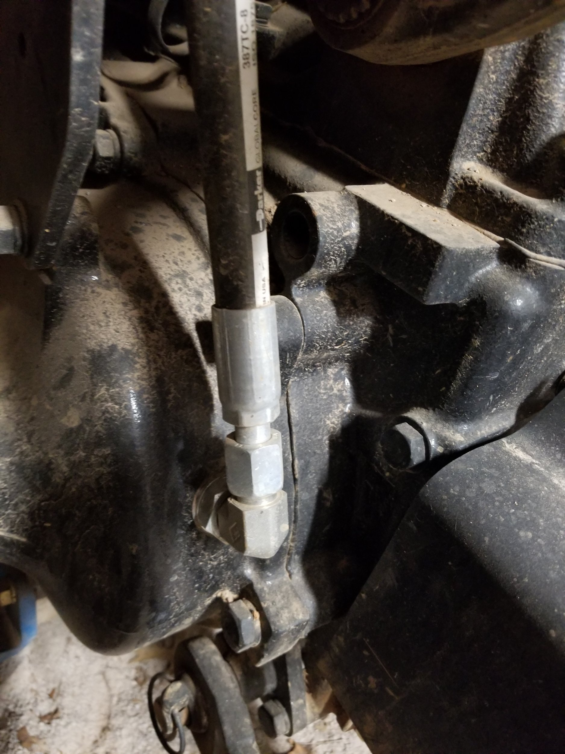

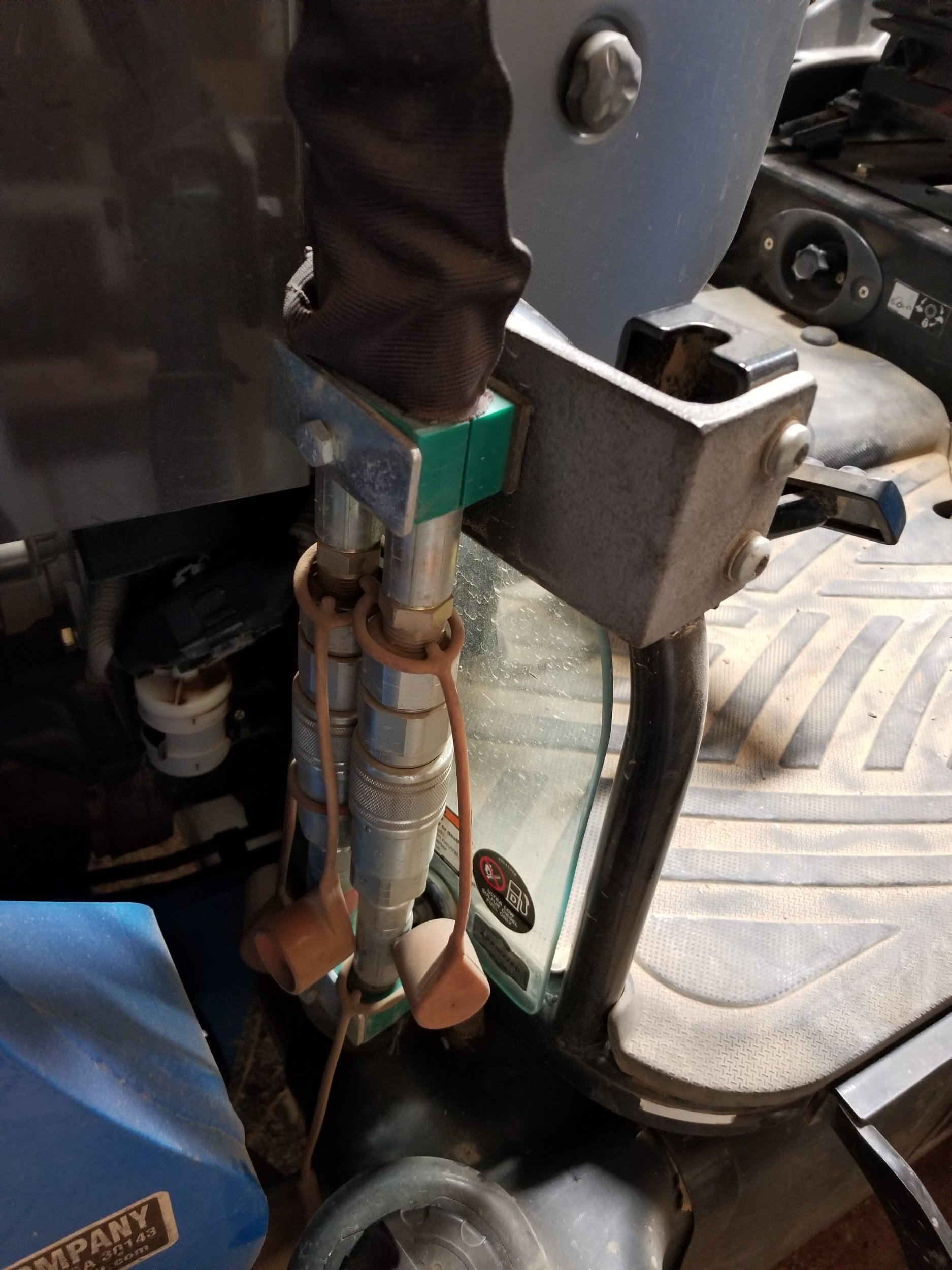

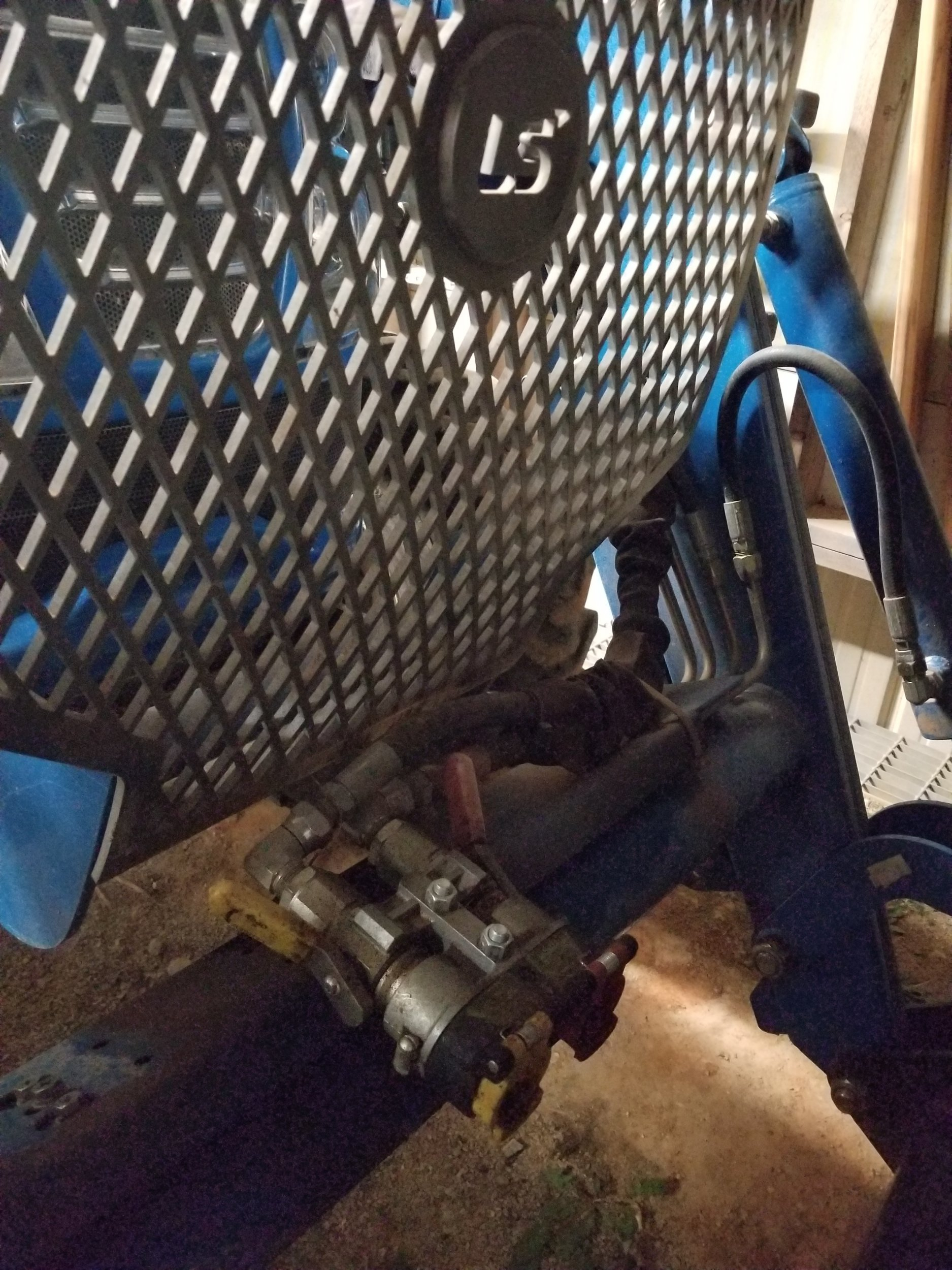

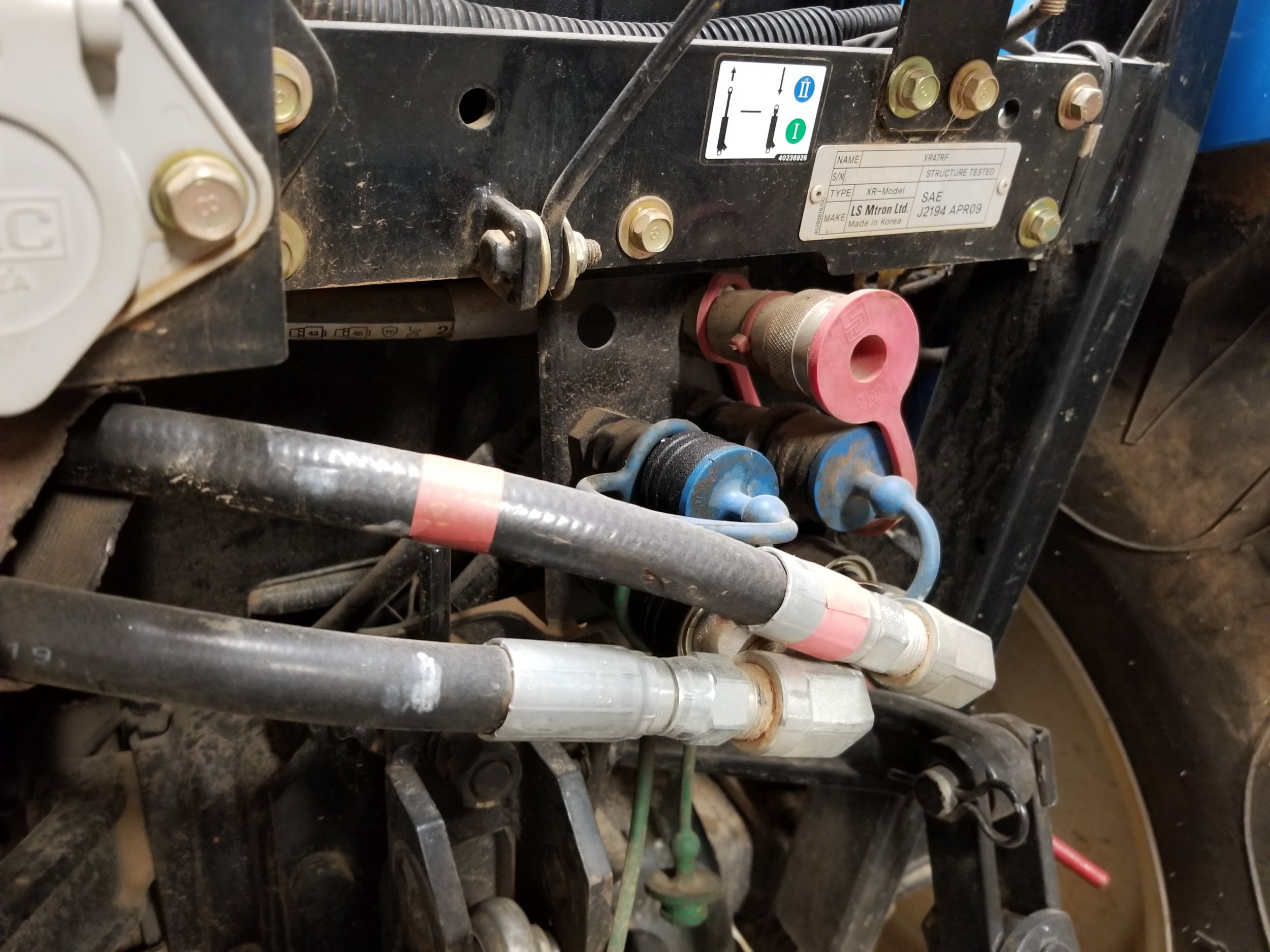

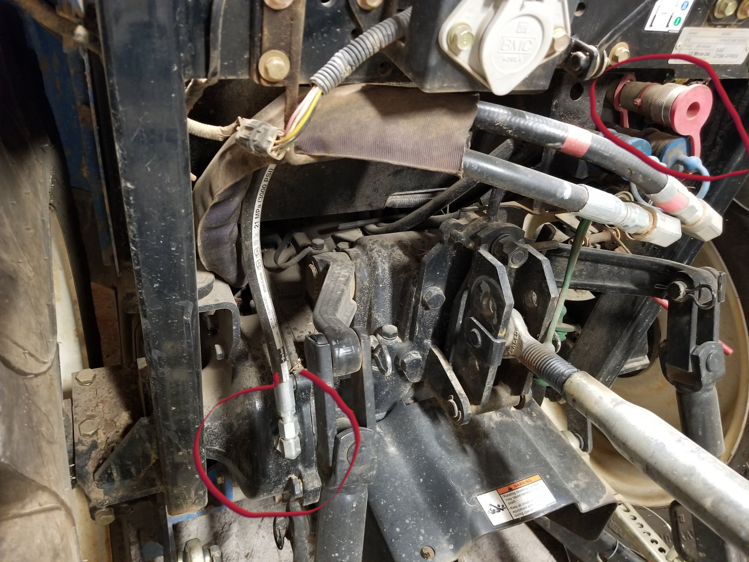

I would be sure that your third function is ok for continuous flow, as some are not. I have a LS XR 4046 and have 1/2" hoses with one hooked to rear valve, and the return line to the rear port to to the sump. They were real helpful when I called with questions.View attachment 604360View attachment 604361
Would you mind sending a photo of how you plumbed the laneshark. I have a ls xr4046 and am looking at getting the 36 inch laneshark.
Thank you
Kenny
   / Looking for Lane Shark feedback from end users #13
I took the plug out of the axle housing and went to a hydraulic shop for the hose and fittings. The photo with the circle shows the 2 ends. There was room in the bracket to add the quick connect. This way I can use my grapple as you see the hoses connected now. When I use the Lane Shark, I move the hose with the red tape, up to the fitting circle in red. This is the return line back to the sump. The hoses run under the floor board on the left side, and up to the loader. I added quick connects to remove the loader, but it's not necessary. On the front you can see the quick connects on the cross bar. All of the hoses are 1/2", and it works great with the Lane Shark. Hope this helps.View attachment 721056View attachment 721057View attachment 721054View attachment 721055View attachment 721058

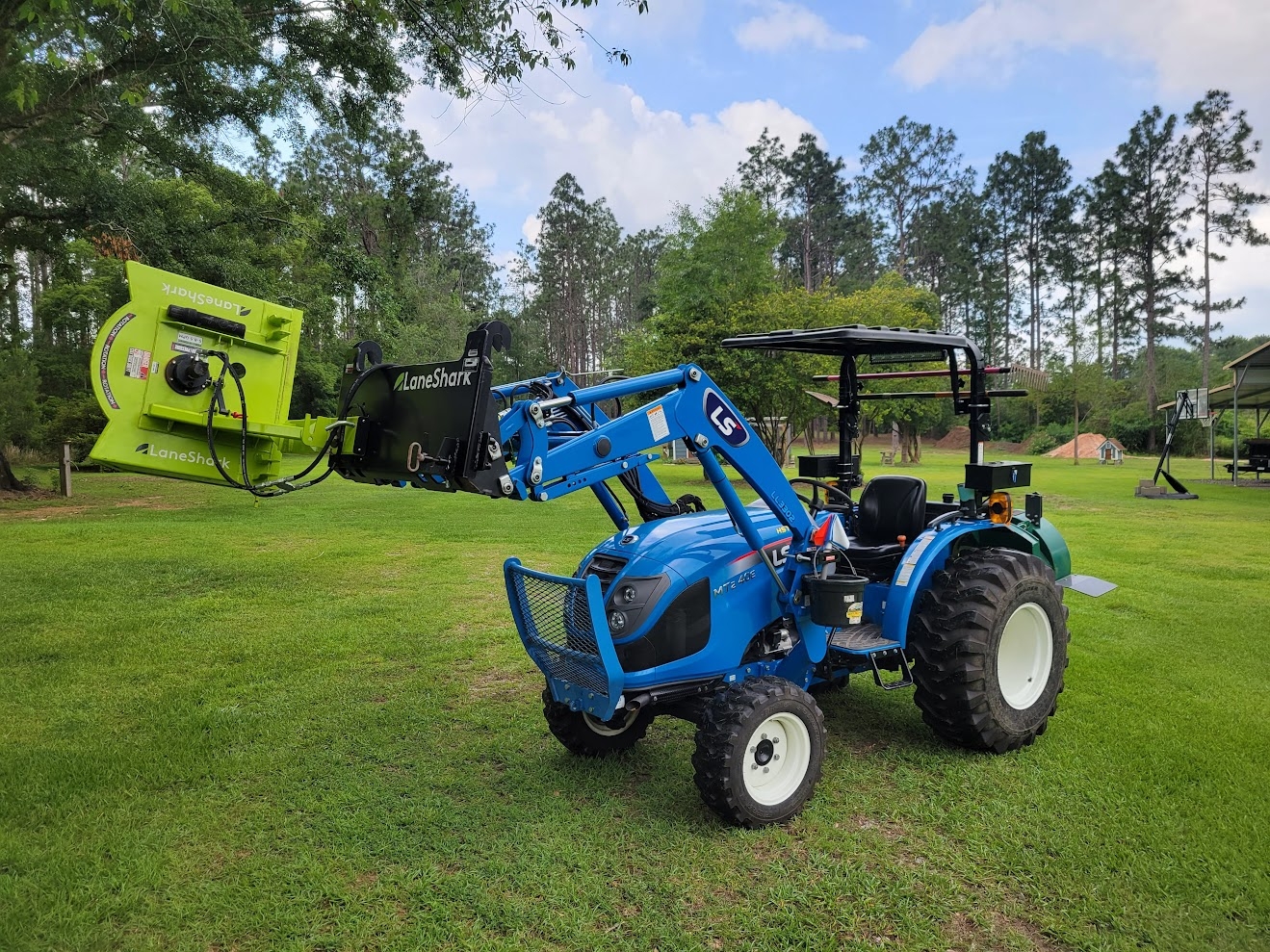

Have probably 15 hours on mine over a year and a half. I have 8 gallons of flow for attachments, no issues so far. I did add the return to sump line. I have the smaller LS3 which only requires 5-8pgm.
