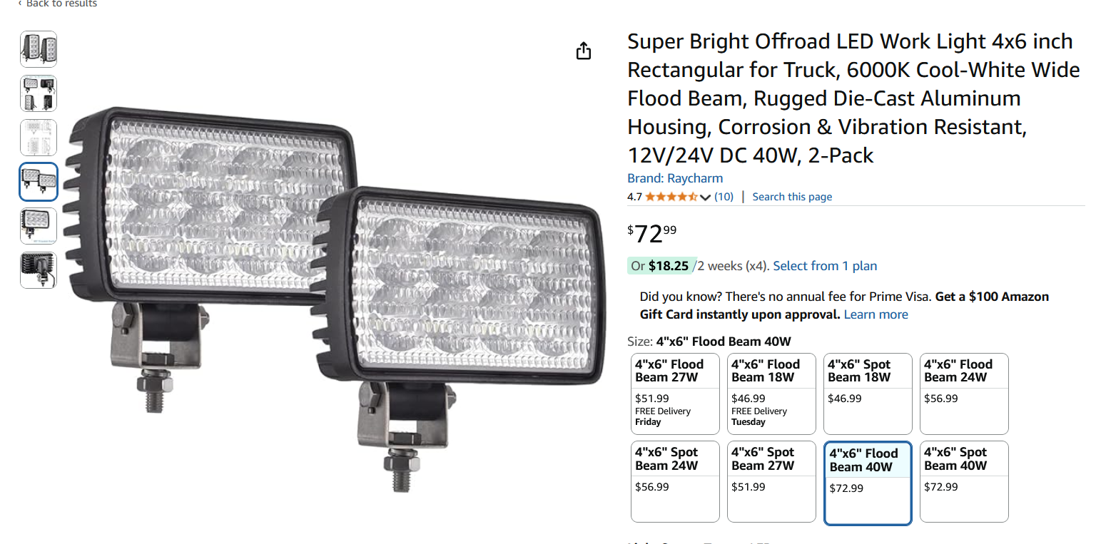

I am going to replace the whole housing. I can't see the amp draw listed on any of the lights. My fuse for the lights I'm changing is 10 amp so I need to keep it under that. Where do I find this or how is it computed. I know draw is low on LED.
Amperage‎6.67 Amps
Look at the › See more product details
Watts divided by Voltage. 80w/12 volts= 6.67 amps
