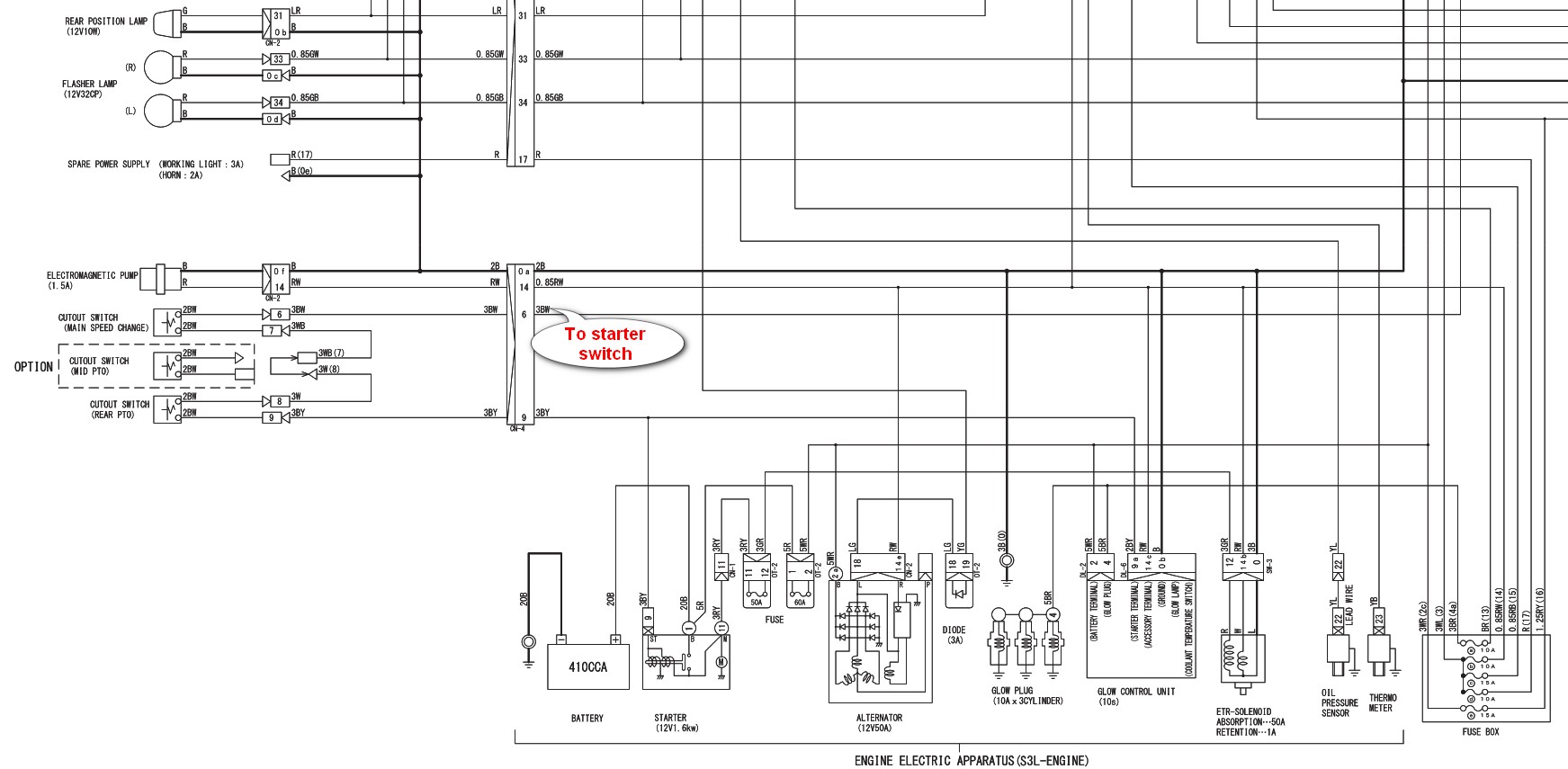

Anyone have an electrical diagram for the 1816 starter circuit? I need to troubleshoot my starter which doesn't even try. I suspect it's the clutch switch which has needed a good kick in the past but would like a schematic of the starting circuit before I dig into it.

This is a sectional screenshot of a 2216's schematic for the start circuit. Pretty simple and perhaps the 1816 is close, but you mention a "clutch switch" mine doesn't have. Mine is the "gear" model, not HST. Not sure if there's difference in the electrics.

Thanks, that's a start. I imagine it's a similar solenoid/starter unit at least. Mine is HST, I know for sure it has a clutch switch, I read on another forum that there's another switch on the PTO control, and I don't know if there is also one on the Low/High range control.
