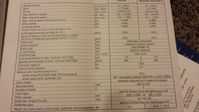

This is probably a dumb question ...
Looking in the manual, it specifies that the PS-510 & 5105 use the same chain.
Sprocket pitch is .325 or 3/8
7 teeth
Chain pitch/gauge is .325- .050 or 3/8 - .050
I found a chain at TSC (Oregon made) 20" , that lists the Makita version of the Dolmar PS-510. It's a 3/8 chain. My Dolmar came with the .325 chain.
So ... Will this chain fit my saw & bar? Do .325 & 3/8 chains require different bars?
I only ever used direct replacement .325 chains when I had my Husky 450, so I never gave a thought to different pitch or gauge.
Thanks...

Yes you will need a different bar for 3/8 chain.

Same sprocket?
No. You need a 3/8 rim sprocket, 3/8 bar and 3/8 chain.
Also make sure the bar and chain are the same gauge, like .050.

Or just get Stihl or Oregon chain in .325, .050, for the 20" bar you have now.

Ok. Any reason to go with a 3/8 chain over a .325 chain? I cut and limbs a 16 inch tree today, & I was very happy with the performance of this saw. Definitely an improvement over my previous 450
I would, but I haven't had any luck finding some listed for my saw
