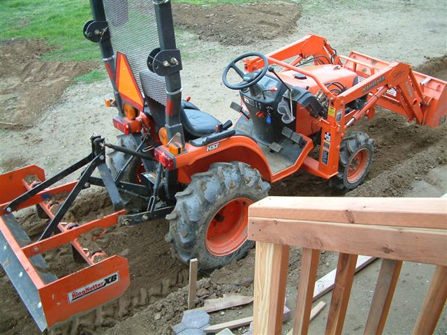

Tractor (30 hp engine, 25 hp pto): new: $10-15K; used (5-10 yrs old): $5-10K; really used (10-40 years old): $3-5K. If you buy new, consider getting a tractor with a hydrostatic transmission, 4-wheel drive (4WD) and power steering.
Add $3-4K for a front end loader (FEL) with 5-ft wide bucket. The FEL is one of the handiest implements to have and you should seriously consider getting one. And if you can afford an extra $800-1000, you might consider getting a skid steer (SS) quick attach fixture for the FEL. This allows you to switch from the bucket to other SS attachments quickly. Here's what it looks like on my 2008 Mahindra 5525 (54 hp engine, 45 hp pto)

Get yourself a good riding mower for your lawn mowing chores.
For driveway maintenance, a 5-6ft wide box blade is normally used ($500-700). Be aware it takes a fair amount of practice to use a box blade efficiently and effectively. Here's the box blade on my 2005 Kubota B7510 HST (21 hp engine, 17 hp pto)

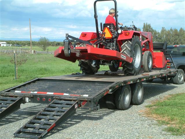

Sure, you can rent implements and tractors, including tractor-loader-backhoes (TLBs) when you need to do serious trench digging.
Implements designed for the 3-point hitch (3pt) on the rear of the tractor are interchangeable from vendor to vendor. I'd suggest you look into a quick attach fixture for your 3pt to make hooking up implements easier. Or else get yourself a 5-ft steel digging bar to auger implements into position when attaching to the 3pt.
Tractor brands: John Deere, New Holland, Massey Ferguson, Kubota, Mahindra. Make sure you buy from a local dealer that you trust so you can get servicing and repairs done without large transportation charges.
And, as the Sarge used to say, be careful out there. Tractors are not toys--they're tools and the can hurt you if you don't respect their power. Check the TBN Safety Forum for more info in this regard.
