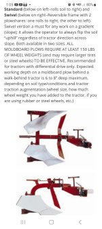

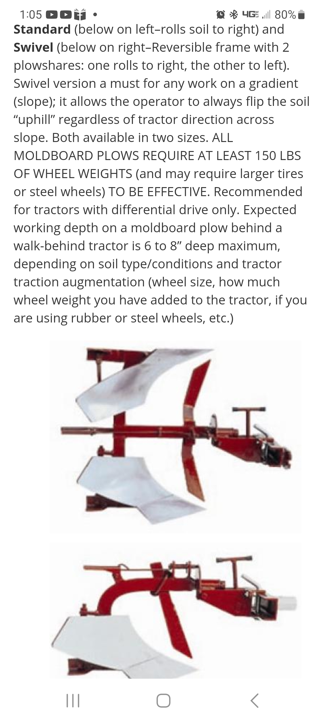

Op, I don't know what your long-term plans are for this 1/4 acre. I have a 1/4 acre garden patch that I'm wanting to expand next year. I use a BCS with a 30" tiller. My brother has one that gets used some as well, but mine is the primary machine. I would till up sod with my tiller. It might take a couple passes to get it deep enough. I've broken up sod with my rototiller and it works OK. I don't try to till it all in one day if I'm breaking up new sod. I'll let the top dry out some before I hit it again. (How long you let it set might depend on where you live.) If you really are set on the mold board plow option, BCS has plows. I'll attach some pics. The tracks aren't a cheap option. I'm not recommending the tracks necessarily, they're just cool 😎 😃 I used my BCS to cultivate between the rows later on. Basically, the BCS can do what a 4 wheeled tractor can do but not as fast. Which is fine for smaller areas up to an acre (my opinion)
