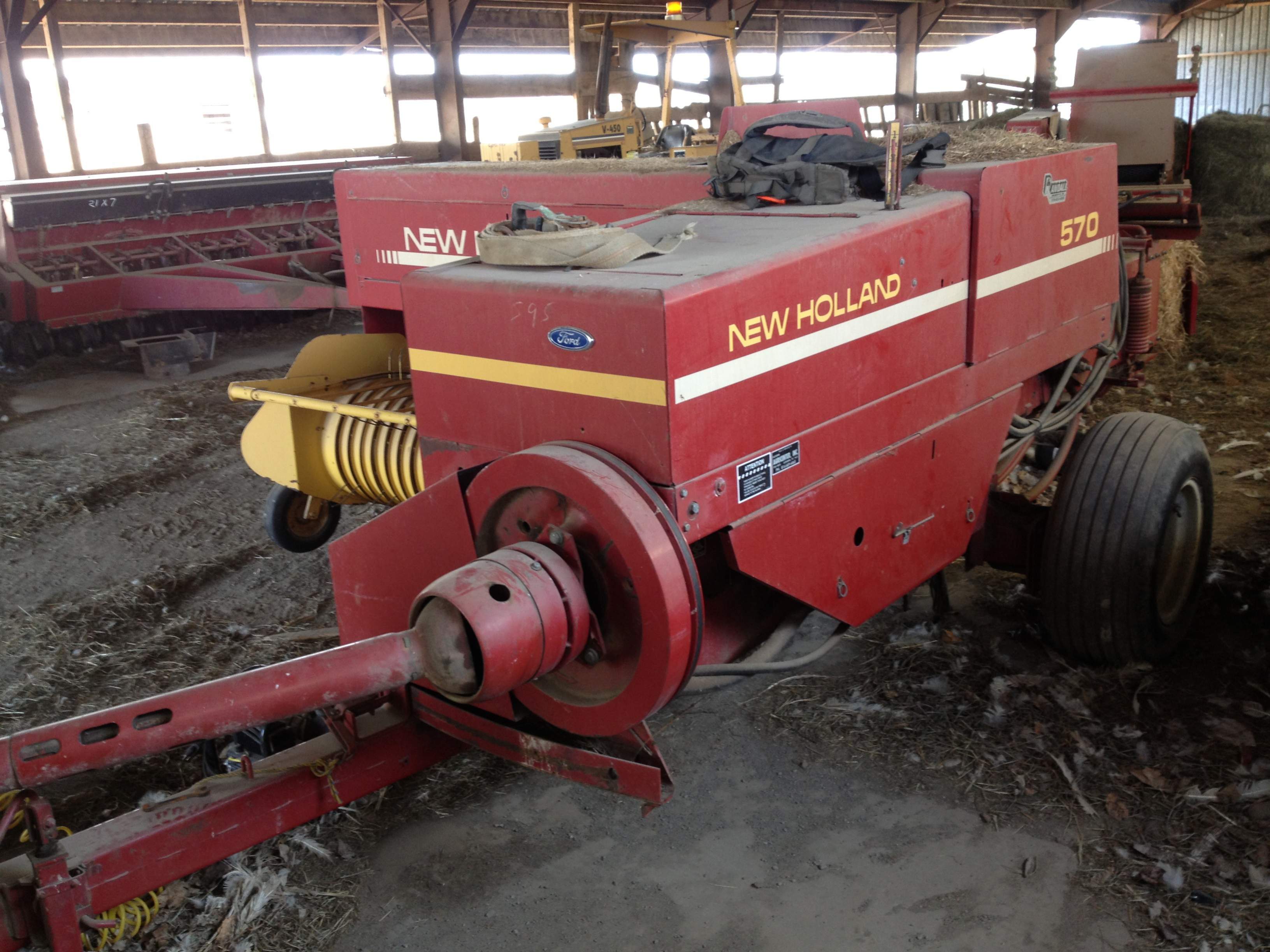

Rick, if it's possible and you don't mind would you be willing to check the year on mine? I'm mostly just curious.

Thanks Rick he said it was a 2004View attachment 313252
As Rick said either late 1998 or 1999, no later than January 1, 2000 the Ford was gone from NH equipment, so the machine is al least 1999. Although I thought it might have been even further than that that the name was dropped. Fiat had 10 years to do so and they bought it I think in 1990.
/ Looking for new square baler #17
I don't care what he said. Does it have a Randall sticker on the far side and another dealer sticker on the chamber side?
I'll bet this is the same baler my customer committed to, then backed out of when he found out the true age.

IIRC it was closer to 1994. Unfortunately I don't recall the exact number I was given. 500 series balers came out in 1988 and the pictured one here has the earliest graphics the series had, including the obvious blue oval. A 2004 machine would have the NH leaf in the same location and probably decals with a black background. 2008 was the last year for these models.

As a matter of fact it did have a Randall eq sticker on it. You are the Sherlock homes of the baler world. LOL. I'm still looking there are a lot of balers out there. Thanks again for all your help
