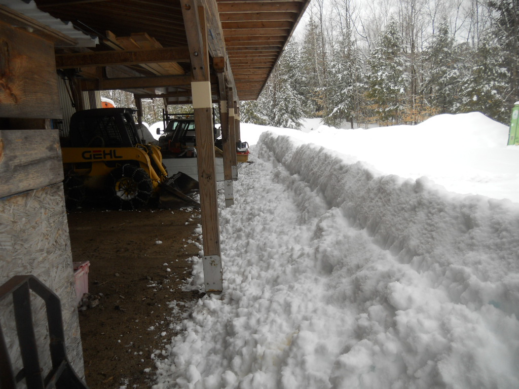

Morton is a good Co. The only trouble with them is they are very, very fast. They'll be pulling out before the ink is dry on your check. Not a "cut" on Morton at all, just an observation, putting myself in the owners "mindset" - spending that much money should take more than 3-4 day's!
I'm sure they will, but make sure they know the local "snow load's" for the roof. Quite a few barns in NY & VT have gone down in the past month.
Also, consider your roof pitch & door location(s). The amount of snow that will come off the roof, especially on the "lean too" side will amaze you. If you can, gable end doors, at least for the most used door's, are a big plus.
This is what I get off my lean too, (from a 12" snow) it includes the main roof above the lean too.
