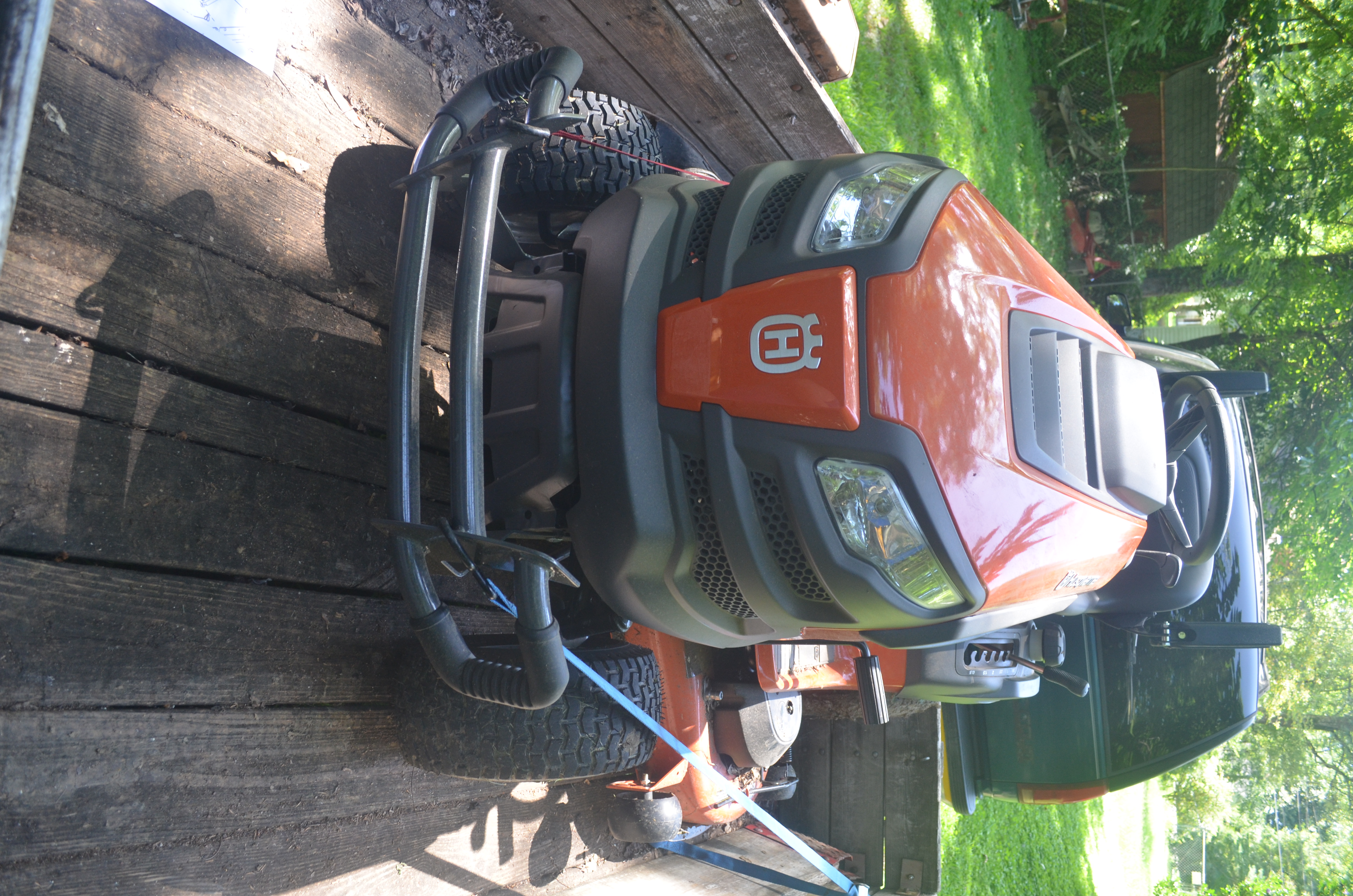

We went with the Husqvarna YHA24V48 near the end of the mowing season last year, so we really haven't had it long enough to give a long time review. I had a drive belt come off soon after we got it, but that was repaired under warranty for free. It has the General automatic transmission that has several good reviews online for durability. It also has a greaseable blade deck bearings that I wanted for longevity, as well as front axle/spindles zerks. I am not a fan of the plastic oil drain cap, but that can be easily changed out. I added a 1" block of wood under the grass shute and now it slings cut grass across the yard instead of in piles.
I used a bungee cord to space it about 2" over the deck on mine too. I like the chute as it's rubber and deflects without hurting anything, shoots to the rear, and helps to keep the grass out of your right eye when in a cross wind. I don't like lumpy piles either.
