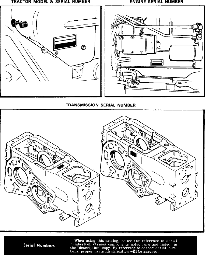

Hi, I am new to this forum . . . I just "inherited" a Case 580 Backhoe-Loader. I am not sure the exact model, I think it is either a 580 or 580B. I found a table that will tell me the model based on the serial number, but I cannot find the serial number. I thought it was supposed to be on the steering column, but there is nothing. Any place else I should be looking?

If i remember right, its on the right hand side of the steering column, easier to view from the ground than the operators station.

No, I haven't found it yet . . . there is a number on the right side of the steering column that is part of the casting . . . it starts with AS, while the serial number I am expecting starts with an 8. There does not seem to be a nameplate, or any markings where a nameplate might have been.

You may be able to at least determine if it is a 580, or 580B by using the engine serial number. At least if it is the original block. I've attached a picture, if you haven't already found it. Located on the right side, right behind the oil filter.
580's engine block numbers started around 2639536.
580B's started at 2711005, according to the Case Construction parts site.
Here is a link to it: CASE
1. Place your cursor on "parts and service", in menu at the top of the page. ( It's pretty small print) A drop down menu will appear.
2. Select "Search for parts", and click on it.
3. Type in "580",where it says "model", on the next page that appears, and all the 580 models appear.
Select your choice on whichever 580 model you wish, then you can drill on down, selecting serial numbers for engine castings, part numbers, etc.
You could probably narrow it down further by looking up certain casting/part numbers, such as you found on the steering column.
There should be a S/N on the hoe too. Probably on the control tower. There should be casting numbers on some of the hyd. cylinders, if that tag is missing.
