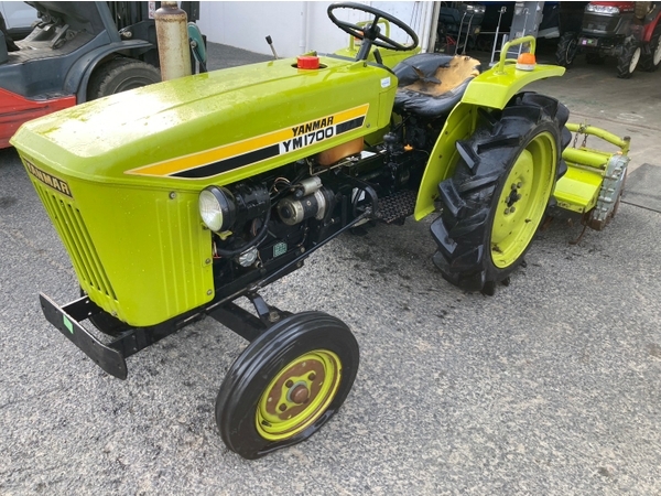

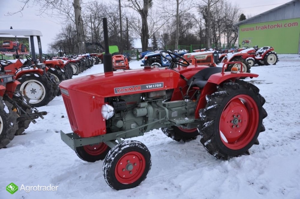

There is also a YM1700B and YM1700BD. There are a few YM1700S machines as well.
So, I would expect you to snag all the manuals I had mentioned since it's unknown what you have officially.
The 1st generation of the YM1700 looked like this in either Tree Frog green or Apple Red.
