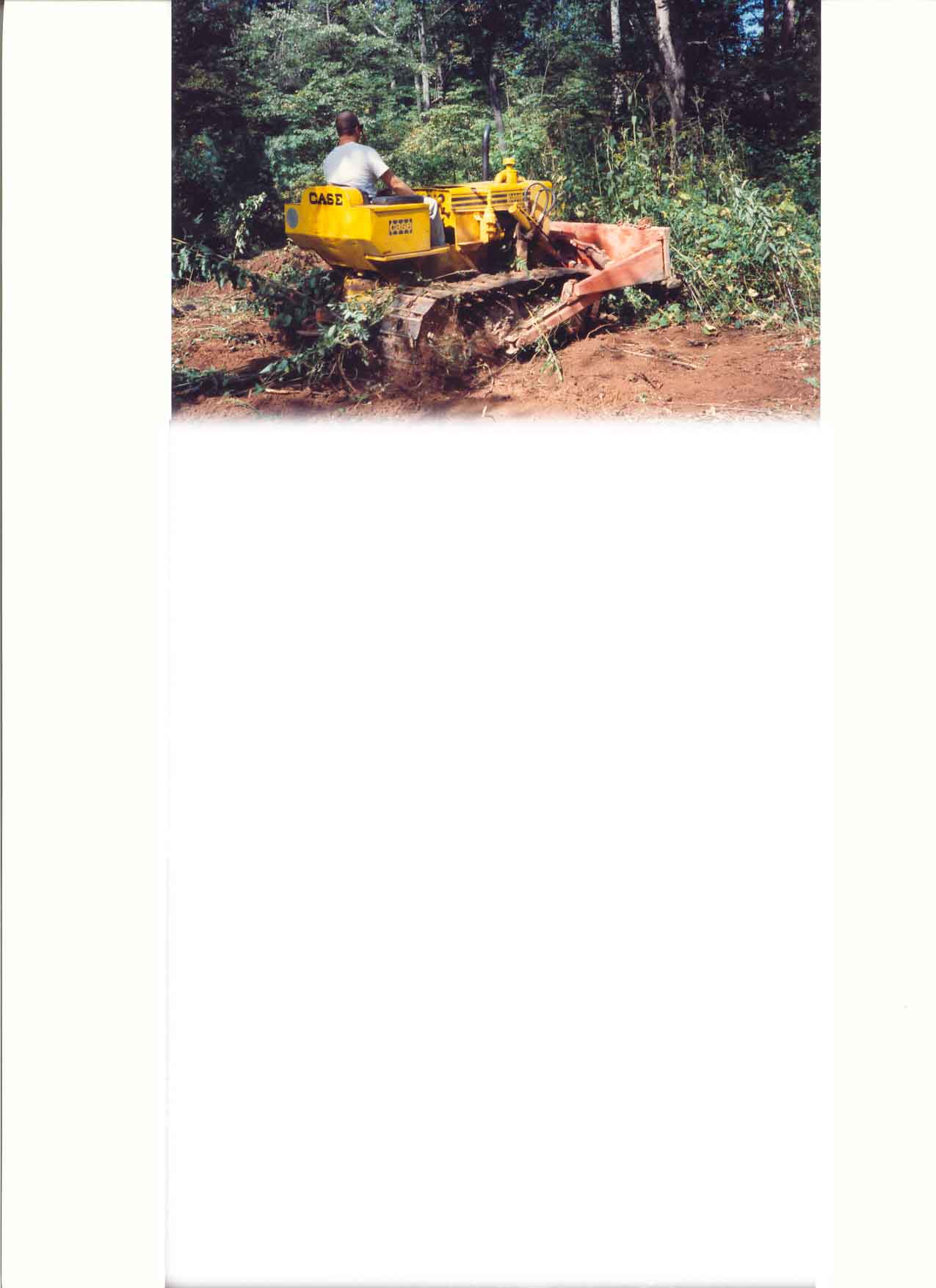

Case 310F, new rear sprockets, new pins, bushings, 3 layer weld on rails. All work done by Clark Automatic in Baltimore MD. More.....if interested send me a PM.

I have some experience on a JD 450G model dozer. It's pretty good for small jobs, but not much on land clearing or digging or moving dirt. Just too light and small to get anything done. The owner of it said he bought it because he can get it unstuck with a backhoe and move it from job to job with a one ton truck on his trailer. When I bought my dozer, I needed something big enough to clear the land and move dirt. Every dozer is a comprimise, so you really need to know what you need it for and buy accordingly.
The JD that I ran had a solic sprocket. The only way to change that was to remove the entire tracks. On my Case, you just unbolt a section of the sprocket at a time and replace it, then do the next section until you have them replaced. Simple and easy.
