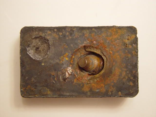

So I've seen 9mm handgun rounds ding the edge of an AR plate. It's just gonna happen. Rifles can do more damage.
Not sure how "flat" you mean it should be, but you'll go through an awful lot of plate if you replace everything with a mark. Just sayin'.
Plates with craters I keep away from pistols. But at 100 yards, a pock mark even center mass doesn't bother me. YMMV.
An edge ding still allows for a flat surface. If there is a "welt" or "crater" that protrudes from the surface it will be sending more back than a flat surface.
Like this section of 1" thick mild steel shot with my 50 BMG.
As above, I have done things that were unsafe.

Absolutely agree that anything that fracked is dangerous to shoot (again). Mine have some dings along the edges, and some light cratering in the field. Still a smooth plane looking from the edge.
Everyone has to do what they think is safe for them. I don't have any religion on it. I have seen people get upset when they buy a pre-made AR-something plate and find it takes hits and shows damage. Nothing is indestructible and 'bullet-proof' is a term of art I no longer use.

Here are som more photos.
If you slow it down enough you can get one stuck (welt on the left is from a stout 45-70 reload)
Trick was to cut the block out of the plate without melting the bullet (.223 bullet for scale).
