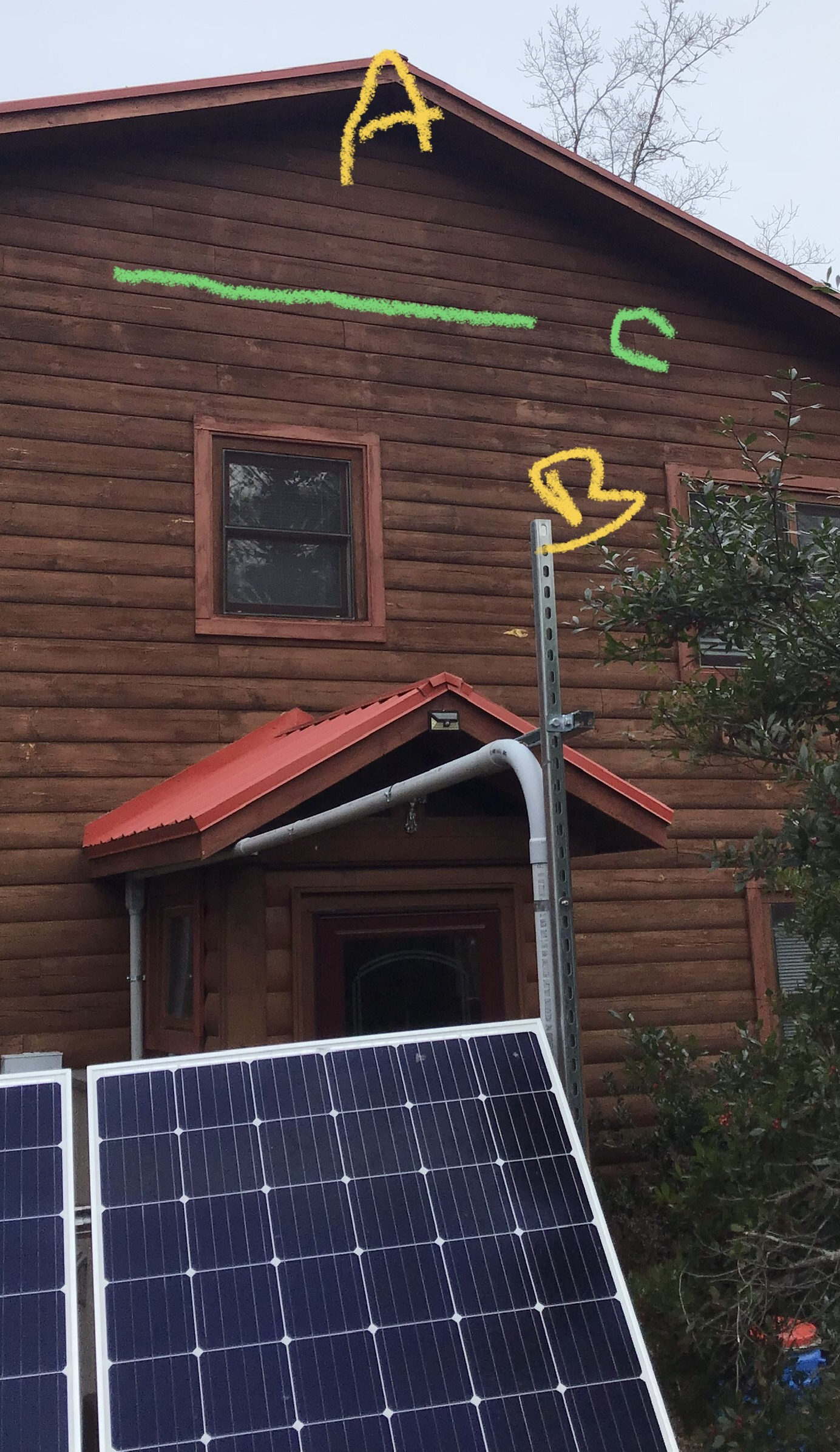

The good thing is, if it doesn't work for you, you have 30 days to return it and get your money back. Time to start planning on where, and how, you want to install it. It typically takes a 6-10 days to arrive and you will want to have as much in place as you can before it arrives.
“A” is where I would like to ultimately mount it, but I still have not purchased my scaffolding yet. . .
”B” is where I will add another 10” piece of UniStrut and place the antenna atop, which will put it at approximately the height “C”, and I can run the cabling inside the 2” conduit that my solar cabling runs through. That will give sufficient sky visibility until I can relocate to “A” hopefully before tree leaves appear. . .

Just remember the dishy needs to have clear sky facing north/northeast. I am assuming your solar panels are facing south, if so, position B will put the dish facing too much into the end of your house. It will work but I suspect there will be a fair number of 'obstructions'. The sooner you can get dishy up to C the better. But it will give you an idea on the speeds you will be able to get.

@KilroyJC A north view is essential for the best experience. I highly recommend that you download the Starlink app and use the visibility function to check the exact visibility at the exact height and locations that you are thinking of. (Yes, I crawled all over my roof tops trying to find a good site for great visibility.)

Iused the app and approximated the angle of view standing on the ground that the strut mount will be and it was pretty good view. He post will be about 16’ from the house, so it has good sight lines over the roof to the north. Not all the way to the horizon, but decent enough.
