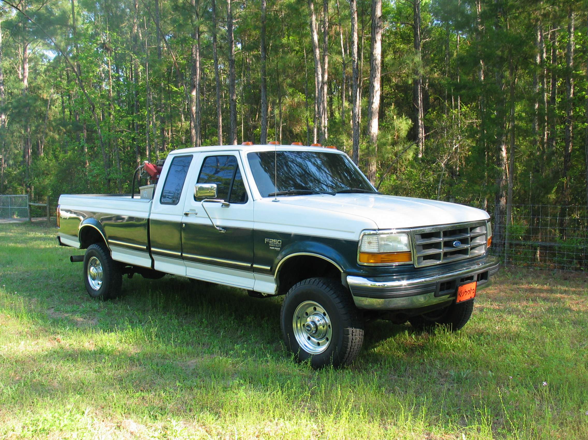

Lots of good suggestions here.......and I wanted to add to not overlook a 95-97 PSD if you can find one.
I have had mine since new and the engine and tranny have never been a problem....I have done some front end work, (hubs, ball joints, and brakes) but it's a 15yo truck with 123K miles on it.
No plans to get rid of it anytime soon.
Stu

Sweet truck Stu!
I love that style Ford. Up here in the rust belt, they are getting tough to find. Plus the snow plowing guys have run these trucks to death.
